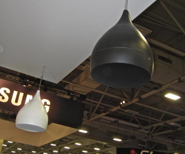

So in ceiling speakers are better ?? Do they make like floating speakers you can hang ? Or do in ceiling allow this ??
Like hanging a light

Atmos is the next step up ??
Yes, Atmos is the latest/greatest codec from Dolby, likewise Dolby Surround is the next step up after Dolby PLII x/z. Atmos is designed for in/on ceiling speakers....how you mount them varies.
