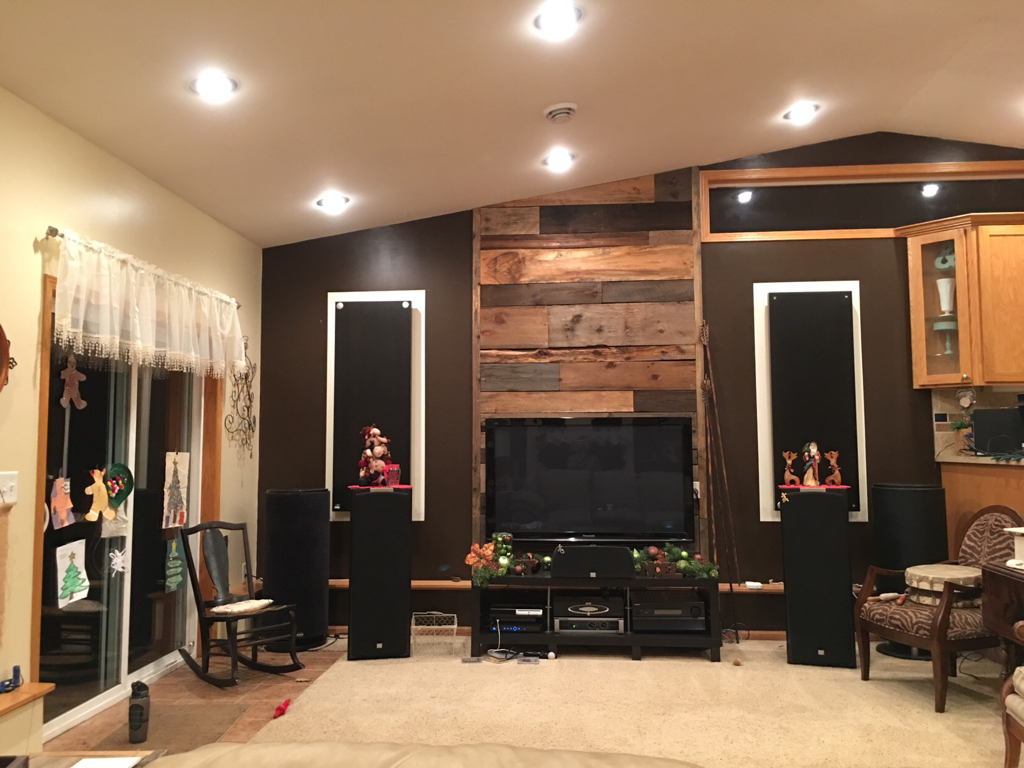

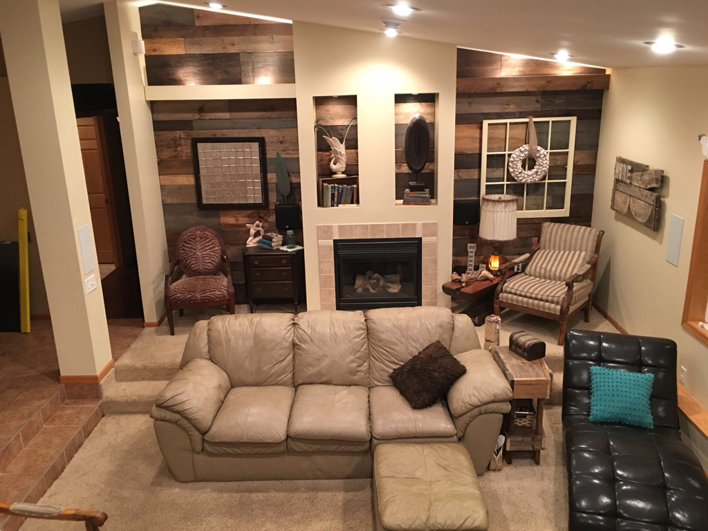

I need to pick your brains a little bit. Sometime after we begin the new year, I will be updating my system for Atmos playback. I’ve already replaced my beloved side surrounds (jbl S38ii) with JBL studio 2 iw55 https://www.jbl.com/loudspeakers/STUDIO2+55IW.html?dwvar_STUDIO2 55IW_color=Black#start=1. I chose them for a number of reasons, but one big one is, I don’t know when I’ll be able to upgrade the LCR,(also the older studioII line) and the new surrounds sound very similar. My wife hates them, (huge) but I won’t budge, and the only way they’re leaving is if I replace them with something with a beautiful veneer or very, very expensive in walls. My ceiling is at a 10deg angle, and the studio 2’s that would match my new surrounds do not come in an angled version. I’ve looked at different angled options such as speaker crafts aim series, in wall tech, monoprice, as well as much more expensive options. I’m not really a believer in aimable tweeters, and I think they might create diffraction and phase issues. Finding the dispersion spec for IC speakers is almost impossible.

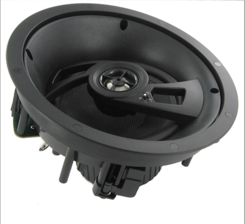

as you can see from the pictures putting speakers in the ceiling with standard driver orientation might cause a problem with dispersion. That’s why I’m looking at something like this. https://www.inwallstore.com/Angled_Ceiling_Speakers_Kevlar_Titanium_Inwalltech_p/hd650_1a.htm then I can hopefully keep them pointed down where they should be instead of at an angle. Do any of you guys have experience with in wall tech speakers, or have any suggestions? Do I even need to worry about dispersion if the speakers are 90deg(45 from axis). The avr will likely be a Denon x4300 and hopefully be able to sort out most timber issues. Speaker heights will be 9’-6” on the left and 11’ on the right. At those distances, I’m also wondering about stepping up to an 8” version vs a 6”. I’m open to hear anything. This will be 7.3.4

The biggest problem I see is that mounting them flush in the ceiling will place the left speaker firing somewhat towards the mlp, and the right into the right side of the room where there is no seating. What I would do is attach bookshelves with an omnimount so they can be angled towards the couch. They will be at different distance but that’s easily fixed with time delay and level adjustment. The studios should do fairly well due to the waveguide. I have no idea what the dispersion pattern is though.

Thanks yep. Bookshelf speakers are a nonstarter. I’m not afraid to push the WAF but part of my negotiation was ok, I will remove my surrounds(wife hates those too), but I’m adding 4 more. Anyways, the point you brought up is the same one I had. That’s why I’m looking at IC’s with an angled driver inside. Like these.
that way they can flush mount and follow the ceiling, but still point down. I could also slightly rotate them to provide a Little “toe” if necessary but I think my ceiling height is high enough that I won’t need to worry about that.

I would be interested to see if Audyssey can correct the off axis roll of of a flush mounted speaker. Since the Jbl utilizes waveguides, I’m going to be that uniform directivity would prevent a roll off that increases with frequency. Again, no idea what the dispersion pattern is, but an example 90 degree horizontal pattern, with the speaker 45 degrees off axis as you previously mentioned, would be -6dB across the waveguides directivity control pass band. Not difficult to correct with eq.

I agree Audyssey should be able to iron out the EQ part, levels, and distances etc. the thing I’m more concerned with is the angle of the ceiling and some weird lopsided imaging anomalies. IME speaker angles have always been important in playback. I just sent an email to JBL. I’ve seen some of their responses to other customers. I’m hoping for a more technical answer than “oh yes, jbl M2 inspired waveguide should provide wonderful experience”lol. Maybe I’m splitting hairs too many ways.
