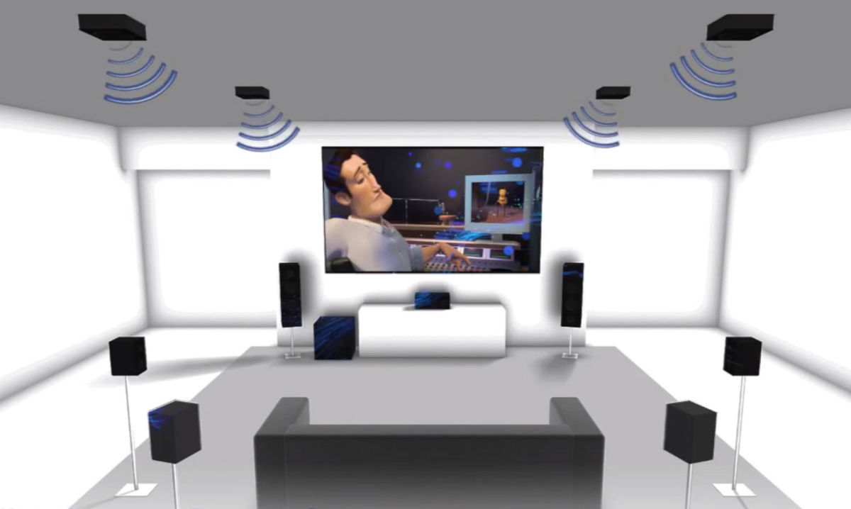

DTS-MA is the standard on regular Blu Ray, so its not being phased out. I would agree, for UHD Blu ray, Dolby Atmos is at least the defacto standard. However, UHD Blu Ray represent a infinitesimal amount of the overall optical disc and regular Blu ray market. Also, I don't believe that UHD Blu Ray will become the predominate optical disc format. Optical will die before that ever happens. If studios want to make Dolby Atmos the defacto standard for UHD disc and allow DTS-X to exist on their regular Blu Ray disc, DTS-X will destroy Dolby Atmos on the market.
As far as which format is superior, I don't know. However, it just seems to me, for the home DTS-X is more consumer friendly, as DTS-X is more agnostic to speaker configuration. Dolby Atmos is in ceiling speakers or up-firing modules. That's it!! Whereas DTS-X can be more compatible with the various speaker placements of what you might in an Atmos or Auro 3D set up.
Atmos is definitely niche, Dolby knows that as well, that is why they came up with the up-firing modules concept because they know most home theater rooms can't accommodate ceiling speakers,(on ceiling or in ceiling) not to mention that most folks don't want to cut holes in their ceilings. The on ceiling or in ceiling approach is, for the most part, for those with dedicated HT rooms, which again represents the niche.
In the above Dolby recommended speakers placements, as you can the see, in the 5.1.4 systems, the four ceiling speakers are firing at straight down at the listener. In the picture above, if your room is similar to this, you have two top height speakers above sofa in the back and to height speakers up front on top where no one is sitting, that makes no sense to me unless you have another seat(s) there.
Also, I'm not that convinced that object based audio is necessarily superior to channel based, given what I have heard commercially from both systems.

DTS-x MAY be more agnostic, but I personally don’t think that means superior, as most lowest common denominators are not. IMO, dts’s claims are dubious and I just don’t believe the playback experience can be as good as real overhead speakers. I think the overheads have to be IN the room(over the listening area vs up against the walls) so the phantom imaging between them and the bed layer can work properly. I haven’t heard an atmos system with prime elevation speakers, or speakers in those locations so I’m am speculating, but I don’t buy it. I have also done many experiments with speaker placement vs imaging and I still think in my conjecture that atmos is Superior.
Also, I agree about most people not going for on ceiling speakers, but IN ceiling for many applications is pretty popular and I think for many, it’s a good middle ground. Many people are desensitized to them. My wife didn’t even flinch when I said I was going to mount 4 rsl C34e’s in our living room.
As far as the Dolby diagram, I wouldn’t put much weight on that. It’s pretty archaic and just used to represent the most basic visual description.
The reason for the speakers being in front of/behind the LP where nobody is is to phantom image throughout the room. Not to create a singular point of sound for each listener.

The reason for the speakers being in front of/behind the LP where nobody is is to phantom image throughout the room. Not to create a singular point of sound for each listener.[/QUOTE]
So in 5.1.4 do the sides surrounds need to create a singular point of sound, or would a bipole surround speaker be an issue at ear level for sides, or is a monopole the way to go for sides? I saw that YouTube with Gene that said to get rid of dipoles but unsure about bipoles with Atmos.
So in 5.1.4 do the sides surrounds need to create a singular point of sound, or would a bipole surround speaker be an issue at ear level for sides, or is a monopole the way to go for sides? I saw that YouTube with Gene that said to get rid of dipoles but unsure about bipoles with Atmos.[/QUOTE]
Content will dictate the behavior of the surround speakers. My personal preference is for monopole speakers in general. I don’t like diffusive sound and my experience with bi/dipoles has been mostly NOT positive. Dolby also recommends monopoles in atmos installations. I do agree with them, however if a room is narrow-ish, bipoles can be ok for surrounds, as hotspotting can be a problem sitting only a couple feet away.
My friend has bipoles in a 5.2.4 setup and it’s pretty good. For myself though, I’d never use them. This is partially due to preconceived bias, and they just don’t meet my performance goals.
I saw you mentioned which way you might go. 7.1.2 or 5.1.4. Fwiw, faced with those options, I will recommend 5.1.4. The phantom imaging between the top rear/top front and surrounds, is much more enveloping than only having 2 height speakers. You’ll still need to have a little room behind the LP, but A)probably not as much(5’min for 7.x.x) and B)it will be more “surroundy “ lol.
