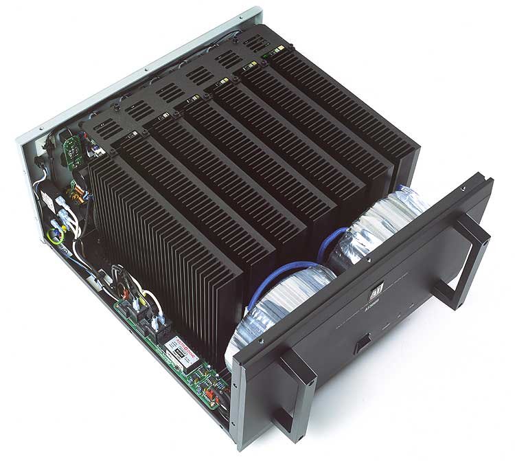

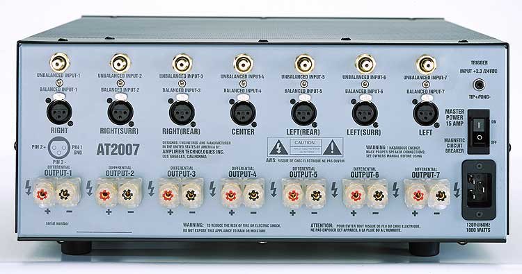

Btw here are photos of the AT2007 (I couldn't find any for the AT2005, but you can add two more channels and turn it into an AT2007):

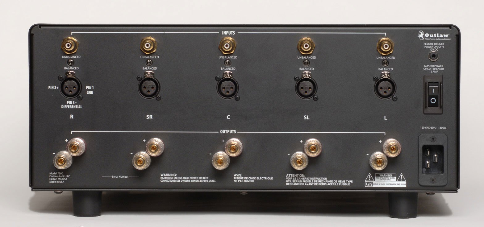

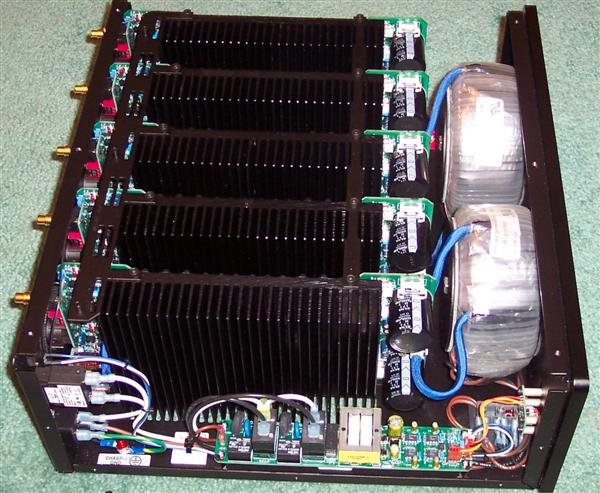

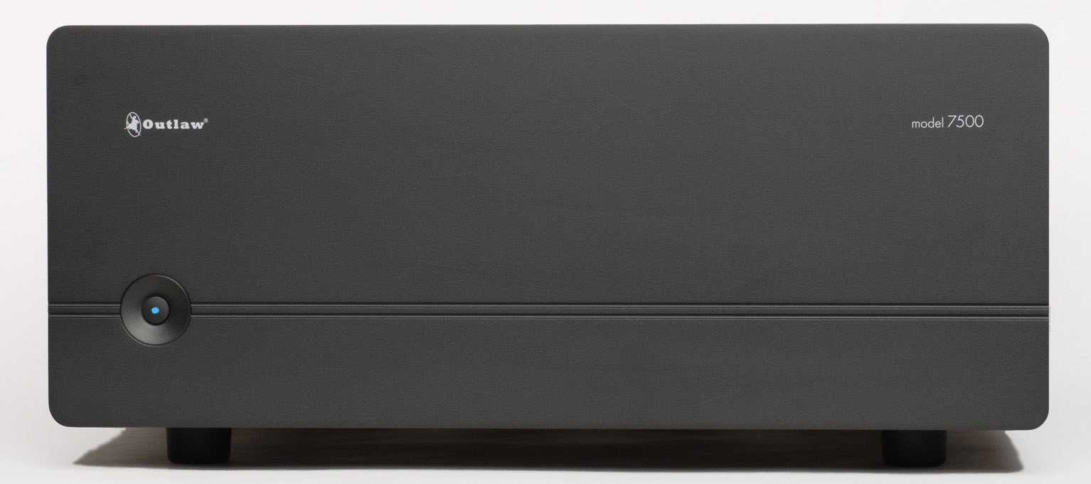

Here are the photos of the Outlaw 7500:
I think they could be cousins.
