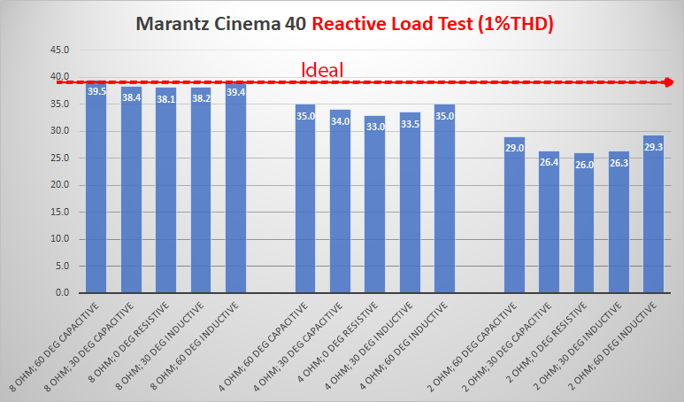

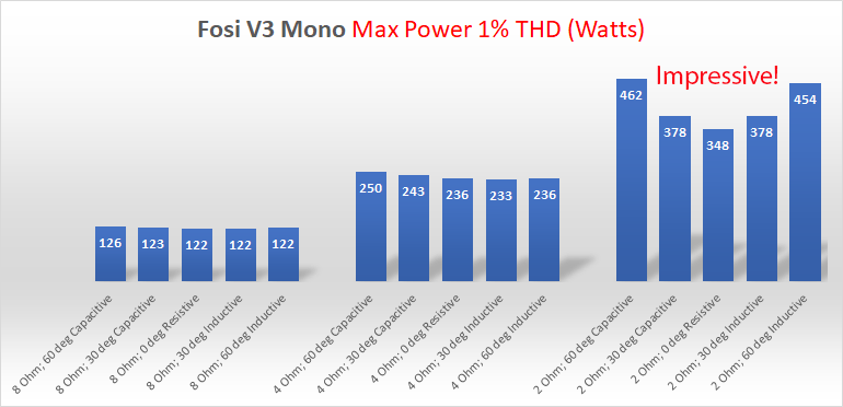

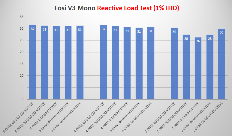

I know the Power Cube test was discussed here years ago- I would like to see the results of modern equipment using that- it shows power output WRT resistive loads as well as capacitive reactance and inductive reactance.
