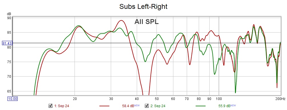

At It Again, Broke Out The Umik
ryanosaur
ryanosaur
I’m in the Midwest... moms is in the hospital. *blech
Anyway, yeah that suck out is bigger than the Grand Canyon!
I’ll have some time later when I’m done with family. Don’t get lost... remember the breadcrumbs, Hansl.

Well that just made everything suck... The nearfield sub measures horribly before and after Audyssey, sigh. Back up front they go. Might stack 'em both on the left side, where they measured much better (terrible on the right, even my main right speaker measures horribly) and run setup again.

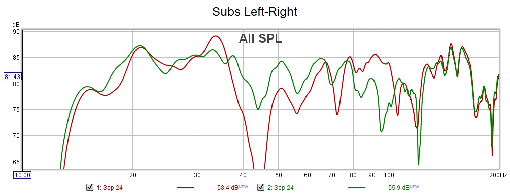

You know, I thought exactly the same thing. I eliminated a couple of nagging questions that have been bugging me and it was worth it. I learned a bit. I put them almost everywhere I realistically could and not be in the way on a permanent basis. Even stacked them on the left side. They actually measured pretty well there, but I don't know if I was sold on the stack so I didn't level match or run Audyssey. May revisit that one day... I was a little limited on RCA cordage or I would have tried one in the kitchen behind me too. It was real work and it took all day, but now I know some more what I'm dealing with. That right side is causing a major suckout.
I did a lot of measuring of my front 4, both all together and individually. The right side is just terrible. Even now it still doesn't measure that great. The good news is, the left side seems to be able to compensate. It measures much better and I'm able to get some pretty decent looking graphs that my ears are confirming as sounding well balanced again. Cleaned up some of the waterfall too. I have 2 things against me over there. That open room and the foyer is bumped out to the front door. I even got every pillow we have in the house and got a stack almost as tall as me in that corner to see if that would do anything (I think @William Lemmerhirt told me he's done that before, lol). Nope. Measured almost exactly the same.
I put everything back and recalibrated. Pretty happy with my results, which are in line with how I had it before.
*Edit: Damnit, those charts keep defaulting to 10 dB on the y axis! I'm one click off from 5 dB. It's very close. I opened the session back up to fix it so I could edit it in and I had deleted the first set of 5 measurements. Grrrr...!

Okay, I removed all filters and turned MultEQ off, then did 2 sub sweeps, left and right. Ugly. Clearly the sub on the right is not happy.
Ok, my thought on this is looking at room size and placement. Specifically, your full wavelength there in that suckout is about 25’, and half- is 12.5’. Are there corresponding measurements between that sub and a wall? What is a little stranger is that the other sub shows it too, and also at an octave up, though the right doesn’t show the octave up.
Anyway, my solution would be to try breaking any symmetries up. If your speakers and subs are in line, move the right on into the room by a couple inches, and lefty back a little, or forward but not as much... try to get them so that they aren’t symmetrical to each other or your towers and recheck. If it is a frequency cancellation due to wavelength, you should be able to break that up.
I had to do that with my towers, and I got 10dB of a 20dB dip back. Just by moving my left side by about 1.5 inches on a ~22’ wavelength cancellation (11’ from driver to wall and back again... showed there, and at the octave!).
I have not tried that and it certainly sounds worth a shot. I understand what you're getting at when you say to break up the symmetry. Sliding one a li'l forward and the other one back probably won't trigger my OCD either! :p
