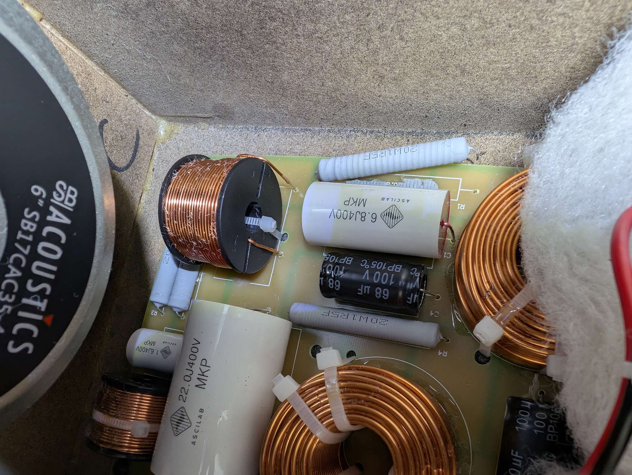

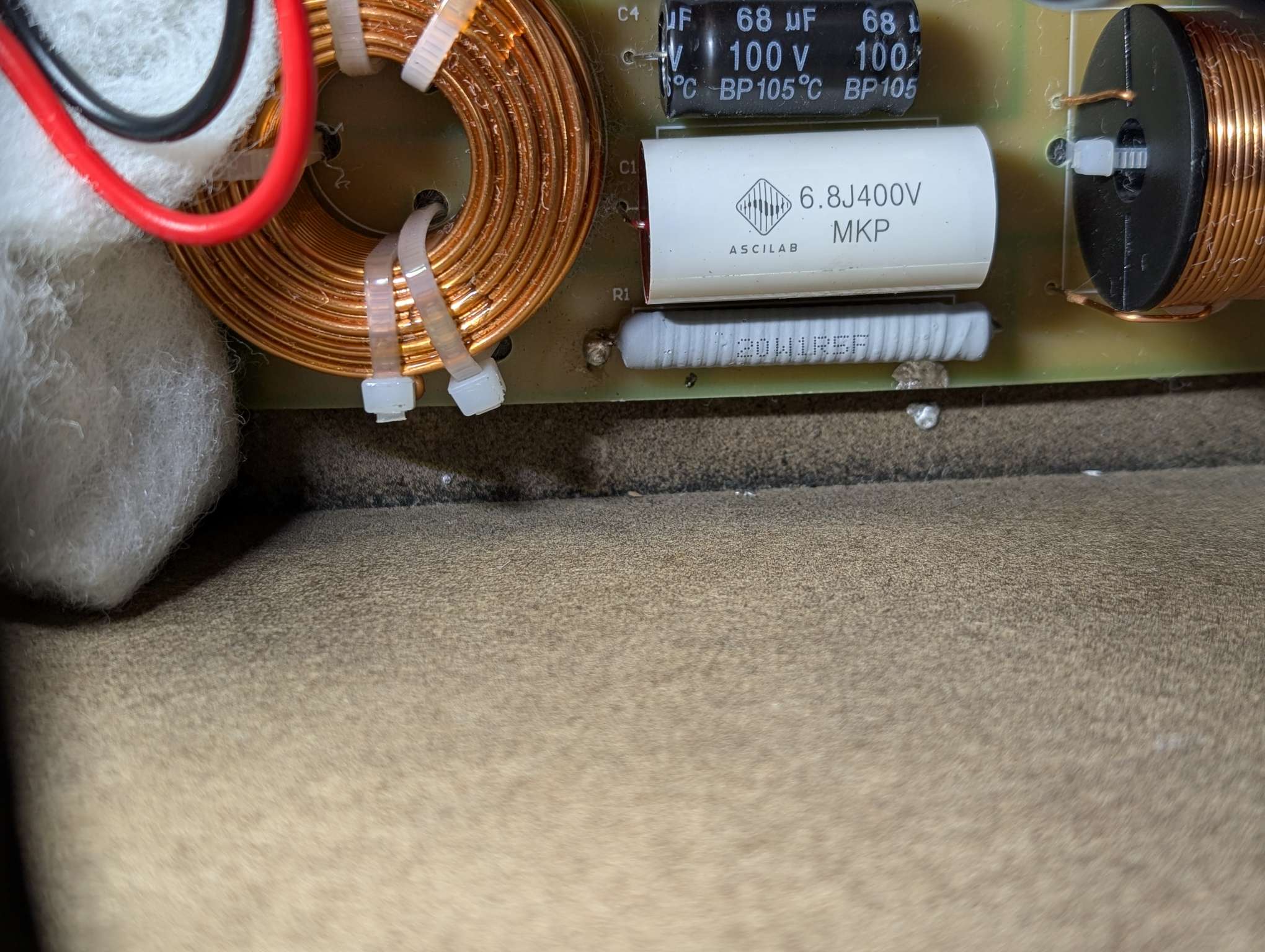

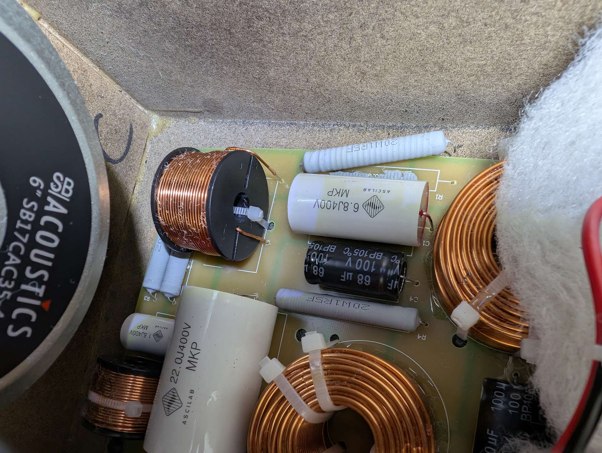

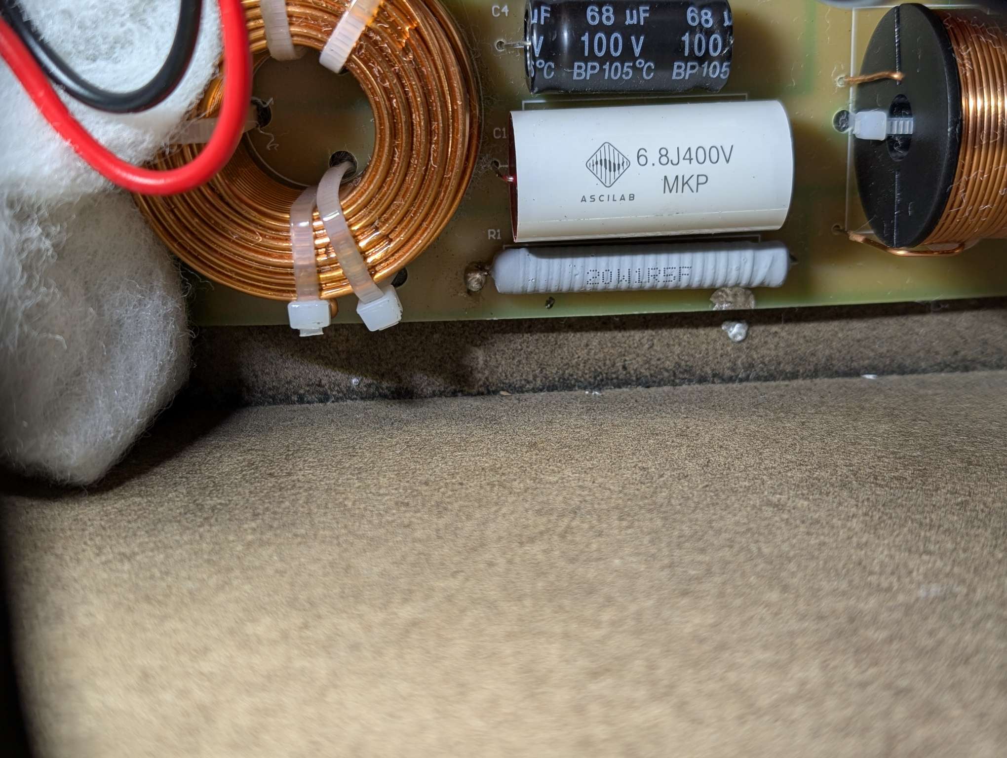

Had a tweeter with no output, troubleshoot with the manufacturer and found a resistor got knocked loose. Thankfully removing the passive radiator gave me enough room to get the soldering gun in there.

View attachment 73694View attachment 73693
The pic shows that the holes in the circuit board are not filled with solder (to be expected on inexpensive single sided circuit boards (without plated through holes), or that the leads did not fully wet; indicating a solder wave or flux issue; or operator inattention during manufacture; there is a fair to good chance that you will, eventually, have to remove the crossover circuit board and re-flux and re-solder each connection on the circuit/solder side, for long term reliability...

Hard to say not being able to see the underside of the board. I would give them the benefit of the doubt they know how to assemble an xover. I blame fed ex's subpar handling of the package if anything

I'm a bit suspicious of the original solder connection too. I can't imagine the dropping force that would be required for the weight of the resistor to break a solid solder connection. I can't tell for sure but it looks a bit like the lead was cut short, so not enough was poking through for a good connection, or when the extra length of lead was cut after soldering they also cut through the solder (I've done that).
Even then, from the resistor coating left on the circuit board it appears that it was also glued in place. Which again begs the question of how could the box be impacted hard enough to jar that loose without other things inside breaking? I just wouldn't think that the resistor would have enough mass to turn an impact into the force needed for breaking the solder connection and the glue to the board.
It would almost seem like it was damaged during assembly, possibly pushed back into place after and then jiggled free when jolted in transit.
Oh yeah, definitely thrown around during shipment. But with that said, could be a blessing in disguise. May have had intermittent dropouts. The kind that drives one crazy trying to locate, isolate.
Funny you posted this up, photo. I always pull XO out, to do a look see on new speakers I received. For the reason you found on yours. I also look at the speaker connector's to each driver, make sure they're properly secure and the right connector sizes.
