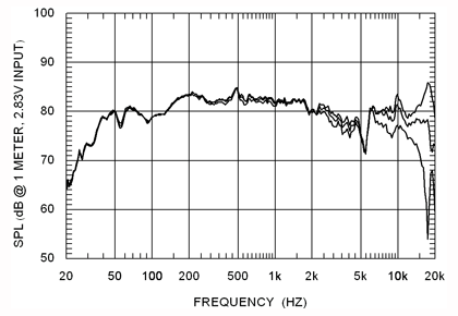

I do not know of any credible 3rd party measurement of the XL-S speakers. The measurements on the distributor web site are far too limited to get any useful data, and are of highly questionable accuracy even for the limited measurement provided. The Strata Mini from that same distributor was measured by the NRC and it measured almost nothing like the distributor measurements - and for the worse. The NRC: there is no higher credibility for 3rd party measurements of which I am aware.
Here is the AV123 supplied measurement response:
Here is the real measured response(NRC):

Those two graphs look *really* different, so i googled it and found a thread at av123 (it includes a link to a review with the NRC measurements):
http://www.av123forum.com/showthread.php?t=23153
Apparently the measurements were taken at different heights.

Even to assume the null is caused solely by the height difference(which means this speaker has terrible vertical response), even the ranges outside of the crossover region(4.1khz is the center of the xover point according to AV123), are very different, and extremely smoothed over. I can't place any trust in AV123's measurements, and besides, AV123 only shows impedance and on axis response, which is useless(far too limited amount of data) to determine anything even if it was accurate.

I wasn't disputing the usefulness or lack of granularity of the data, only the obvious huge discrepancy and a possible explanation for it. I'd expect the "smoothed" graph to look much more like the NRC graph, just with less resolution if both were taken the same way.
It's not surprising the mini is very directional vertically, as the entire speaker is "tipped back" and the tweeter is already facing what appears to be 20-30 degrees above level.
