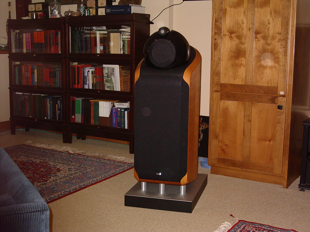

Those are 801's; though I can't tell series by sight (I think the options are "80", "II", and "III"

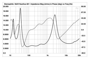

Sorry Jerry, but you just fell headlong into a common trap!
Those speakers are 91 db 2.83 volts 1 meter and NOT 91 db 1 watt 1 meter.
Here is the route cause of your problem and misunderstanding.
Your speakers are rated at 8 ohm but are nothing of the sort. They have a minimum impedance of three ohms. So the way they are specked they are not letting on how much amp power is actually drawn from the amp to maintain that 2.82 volts. A sensitivity rating does not correlate with efficiency! When rated like your speakers it tells you nothing at all by itself, about how much amp power you need.
I can assure you the large B & W 800 series speakers like most esoteric three ways, take just gobs of power below 600 Hz. The phase angles are also highly adverse, and three ohms is not even the whole story, as at some frequencies the power drawn is equivalent to a load actually below 2 ohms.
So your receiver will be highly stressed trying to drive those speakers, and actually likely only able to deliver about 25% of its rated power before clipping.

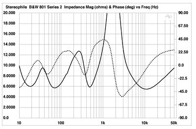

I found the Stereophile review of the B&W Matrix 801 series 2 speaker from December 1987.
Skip the 6 pages of verbiage and go directly to the Specifications page:
Crossover frequencies: 380 Hz and 3 kHz
Frequency response: 20 Hz-20 kHz ± 2 dB free-field
Sensitivity: 87dB/W/m
Nominal impedance: 8 ohms (not falling below 4 ohms)
Amplifier requirements: 50-600 watts
And look at the measurements. The first figure graphs impedance vs. frequency (solid black line). The bass and midrange never drop below 6 ohms. The tweeter does drop a little below 6 ohms at 10 kHz, but I don't think that should be a problem for an amp. Still, I agree with TLS that this speaker benefits greatly from a big amp.
I scanned the rest of the graphs, but saw nothing that might suggest an explanation for the problem you hear. To get at that you would need to see separate frequency response curves of the midrange and the tweeter, while each is connected to the crossover circuits and again while disconnected from them.
Go find the review for the Nautilus 801 and see what its specs are. I suspect its impedance curve might go lower than 4 ohms in the bass freqs.

I was referring to his 801N.
You will see those speakers are 3 ohm from 70 Hz to 300 Hz. when allowing for phase angles and the current to be provided for the apparent power, those speakers will suck the life out of any receiver.
His 801 series 2 has been mucked about, but it would be the easier drive. The midrange on that unit is not nearly as good as the ones in his 801N. I never could really get on with those B & W speakers from that era, despite high praise from a lot of quarters. My friend Phil had a pair of these for many years and my brother is still using a pair.

The Nautilus 801 would definitely suck the life out of all receivers and many separate amps too :eek:
I should have included images of the two graphs, first the Nautilus:
for comparison, the Matrix 801 series 2:
