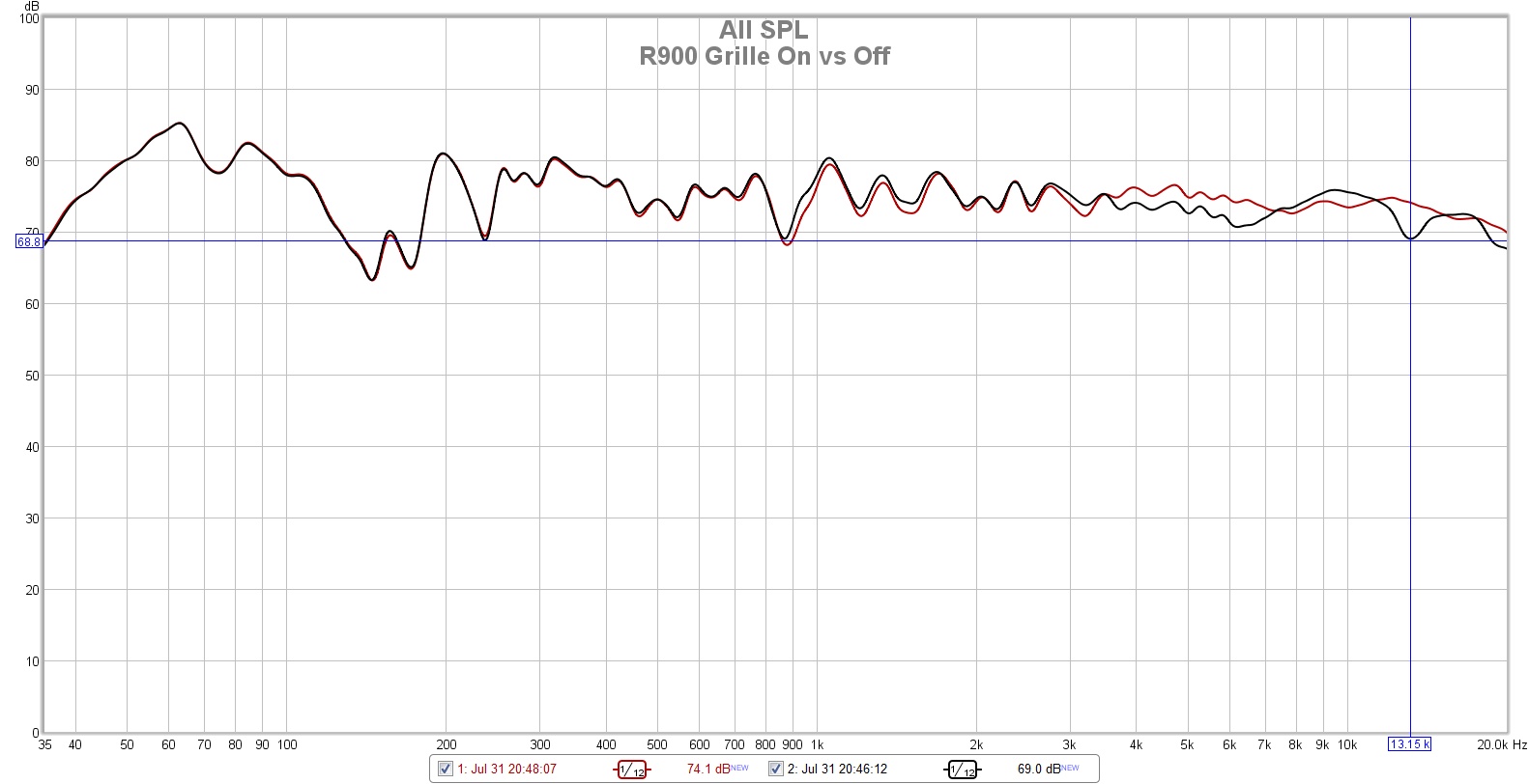

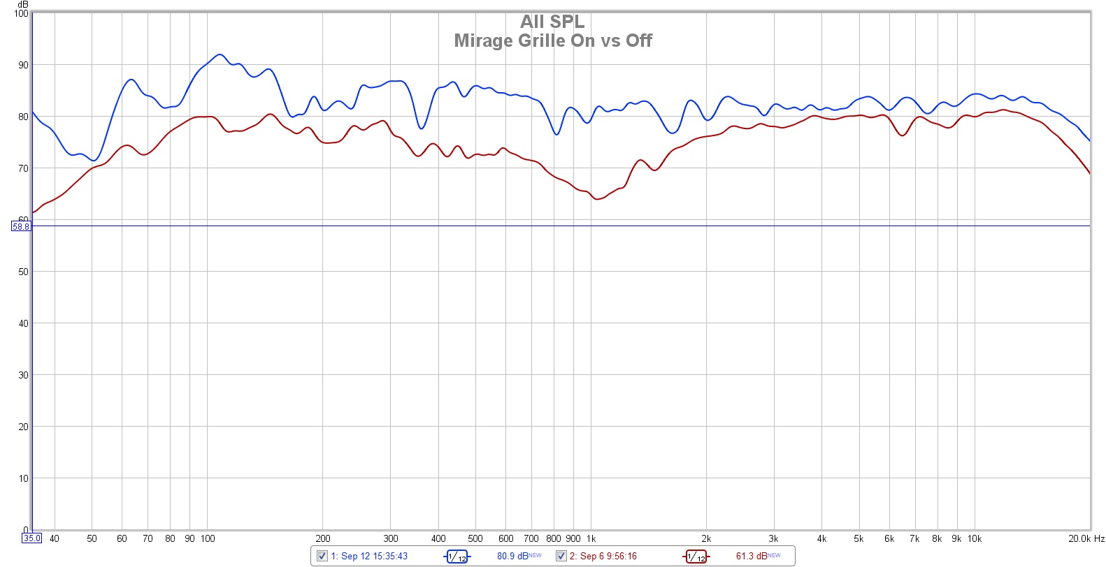

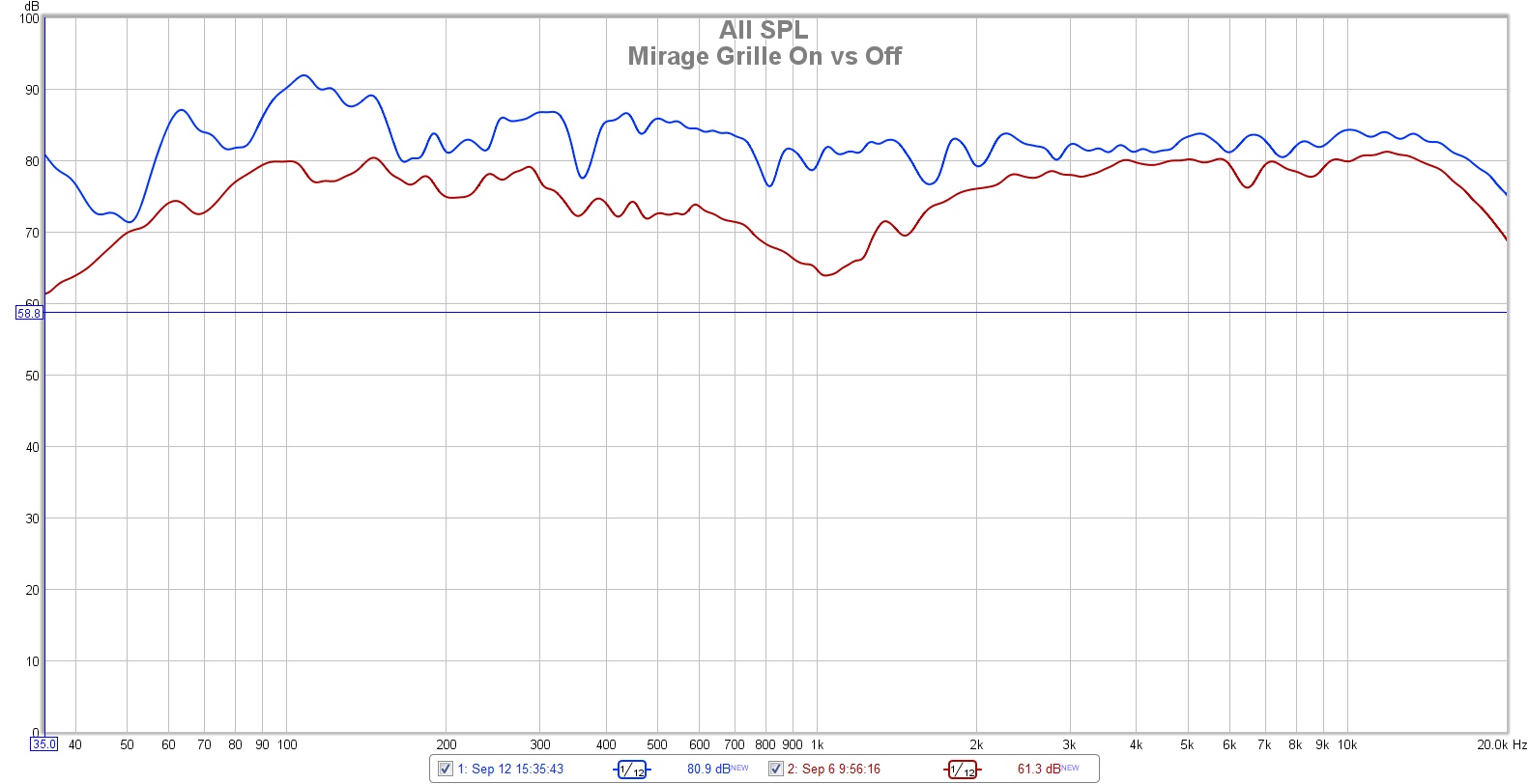

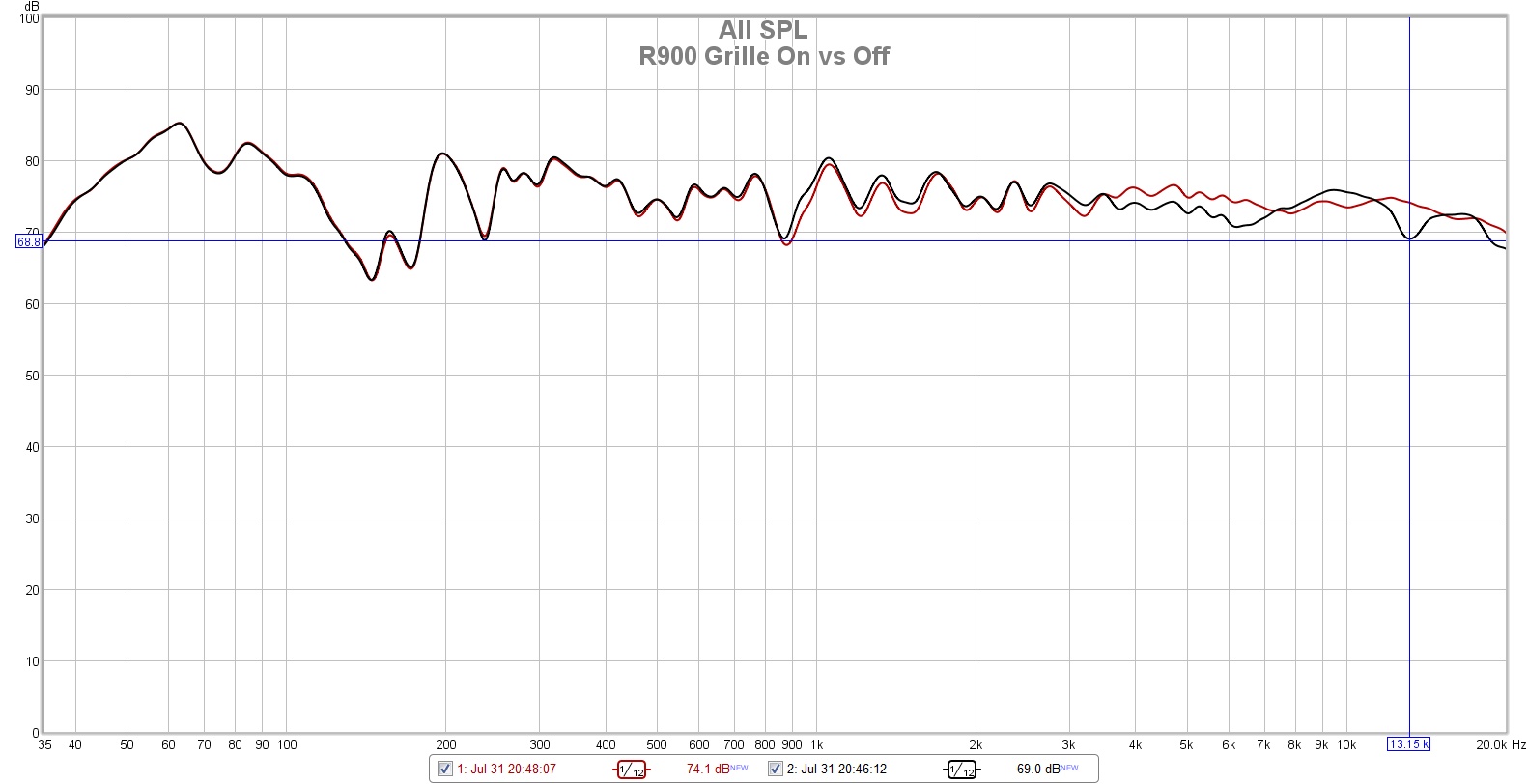

I understood the grille you referred to was just for the shootout. The word grille simply reminded me of my recent discovery of the difference they made to two of my speakers and not to the other two. Looking at the graphs for the Mirage, they must have bad grilles but good in the sense that they seem to act like a good EQ system that levels the frequency response.:D
The Mirage grille on was from 1M whereas the grille off was from 6ft as they were not done on the same day. The R900 one's were done with the mic in the same spot the difference was just grille on vs off. You can see the 5 dB dip at around 13,300 Hz when the grille was on.
I guess I am getting off topic but you have the power to move it to where this belong right?
I've never seen a grille being that lossy. I think you need to remeasure at the exact same position on/off.

Protective caps won't do much in terms of losses or diffraction but the grilles will have a more profound effect and it's usually NEVER better to have grilles on then off.
I will redo it with them mic at the exact same location for the Mirage. I did that for the KEF R900 because I got alerted by the dip and wanted investigate the cause. So the 5 dB (more if I apply 1/48 smoothing instead of 1/12) dip at around 13 kHz with the grille on was real and repeatable. Good thing the R900's grille is magnetic so on/off is effortless. The inexplicable part is that the dip looks like a notch filter effect, I wonder if it has to do with the KEF tangerine guide thing. I mean, how can the grille diffraction effect act like a narrow notch filter?
In the case of the Mirage it was done on different days, grille only went back on when I was ready to focus on listening. Then I thought I should measure it again and got the surprise result albeit a nice one as it looked much smoother.
