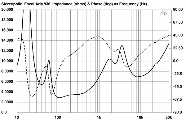

Im going to be running a 5.4.2 with focal Aria 936 Fronts
Can the Anthem MRX1140 drive my fronts? Its rated at 140watt @8 OHM however I'm told it actually runs around 100watt. Anthem is 1% THD. So more like 100w clean at a very high volume, and thats just the fronts, the surrounds are less.

That is an adverse load. It is below four ohms from 80 to 500Hz. The phase angle is highly adverse at 80 Hz.
That is an expensive receiver, but no specs are available at below 6 ohms. I would recommend you protect that receiver with external amps to those speakers.

The Stereophile review of the Focal Aria 936 claims a nominal impedance of 8 ohms, with a minimum impedance of 2.8 ohms, as shown by Swiz in his OP. The review estimated sensitivity at 89.5 dB, somewhat lower than Focal's 92 dB. Focal recommends amplifier power of 50–300W.
