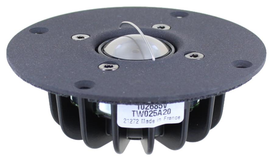

You are correct. There are major problems in the design of that tweeter.
I'm certain the tweeter they selected is the Audax 1" (28mm) tweeter.
They only have two Titanium domes to choose from and it is not the Vifa for sure.
Now this tweeter has an Fs of 1137 Hz. So at a crossover of 1600 Hz this tweeter will be driven down though Fs even with fourth order electric crossover.
Now you can only drive a tweeter down though Fs if it is low Qts. However this tweeter is high Qts. It is 0.76!
This graph proves the point showing the impedance rise at Fs and the peak is broad based high Q.
That speaker has to sound awful to anyone with a trained ear.
There are always some in the crowd who will claim the most dreadful speakers sound great.
However that Arendal outfit are neophytes. They do not know even the most basic rules of speaker design. Unfortunately fat too many think they can produce speakers and not know the most basic rules of the craft. Here is another to add to the list.
The arendal uses soft dome tweeter, not hard dome titanium.
And is 28mm not 1"(25.4mm), so they cant be the audax you implied.

Physics will argue with the Doctor and his team.
I suspect the Doctor was commissioned to develop a tweeter following a list of Marketing Department guidelines to separate themselves within the market. For the given compromises inherent in asking a small dome diaphragm to operate through that many octaves, I am sure the tweeter is 'remarkable' in that it functions with out damaging itself, or the ears of the listener. But I will remain skeptical until I can hear a pair in my room!
There are others using waveguides and very low x-over points with great results, so what's the problem? Amphion does that on all their speakers and they're so succesfull in that they're favorites for quite a few studios. I don't think Amphion does that for marketing reasons, do you?

Just because they exist, does not mean they should! Thats too broad of a range for a tweeter. And then still expecting the midrange drivers to handle bass frequencies... there is no logic in that design. So I assume it was Marketing!

But it's still "guesswork" from your side?
Do I have a degree in physics? No!
But it's 2016, and we have a very good understanding of sound reproduction. Crossing over a tweeter extra low to allow mid range drivers (or unusual woofers) to even attempt reproducing mid to low bass frequencies is nothing but a compromise in performance, for the sake of budget.
My focus has been entirely on the low crossover point of that tweeter. I do not question waveguides universally. Merely when one is shaped in this way, the best out come, whatever it does, is that it is inaudible!
Don't know what other speakers you've heard, but I think taking advantage of domestic pricing on SEAS drivers will yield the best possible experience! And I'd hate for you to drive several hours to hear those speakers!
Low xover point on "that" tweeter?
Do we even have any info on what type of tweeter used besides is a 28mm in a wave guide?
By the way, i know at least 2 Seas tweeters that can be crossed low (1.5khz)
It's written up above in an earlier post who makes the diaphragm and the waveguide, but not said anything about who produces the motor and does the assembly, but it's nothing off-the-shelf...
