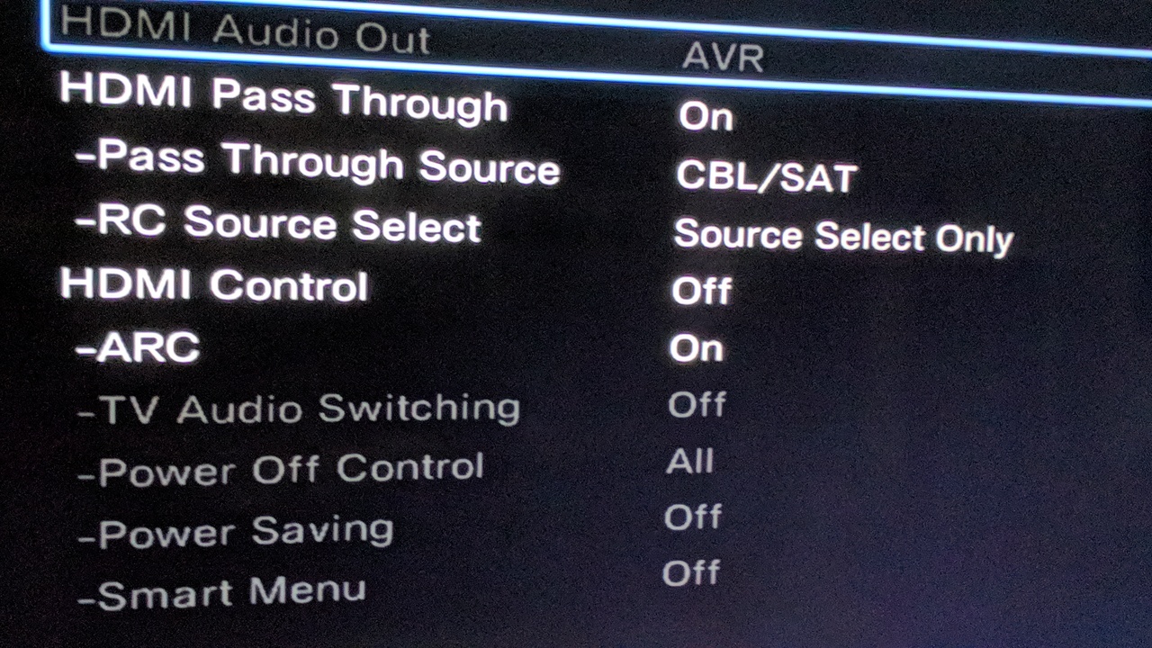

Okay then, you should try turning CEC (HDMI Control) off on the Denon. Then, repeat the same sequence of switching on, but only after unplugging the power cord from both the TV and the AVR first. I remember having to do that in the past, before the last several FW update.
With the latest updates, I no longer need to do the unplug trick, but occasionally still have to turn off the AVR and turning it back on. That's still miles ahead than before so I would say ARC is in fact getting better, easier now than a couple years ago.
Here's a screen shot of my Denon's setting. No point to show the TV one as mine is Sony, not Samsung.
Thanks - that's how I had it set up initially when it was working -- was told in this thread that ARC would not work without CEC (HDMI Control) being on. That's when I turned CEC on in both the TV and the AVR. The only difference is that I had a different Pass Through Source set (although I don't think that is applicable to the ARC issue).
I will set it back up the way I had it before, unplug the power to both and try it again. I'm pretty sure I tried that already, but I have tried so many combinations since this started that I cannot remember.
