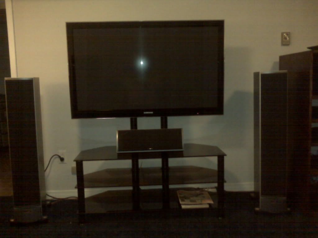

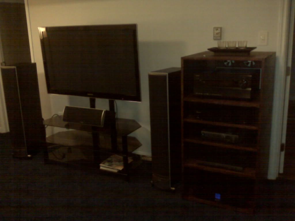

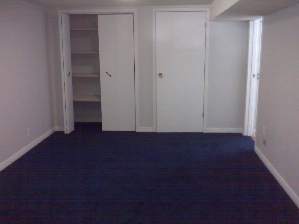

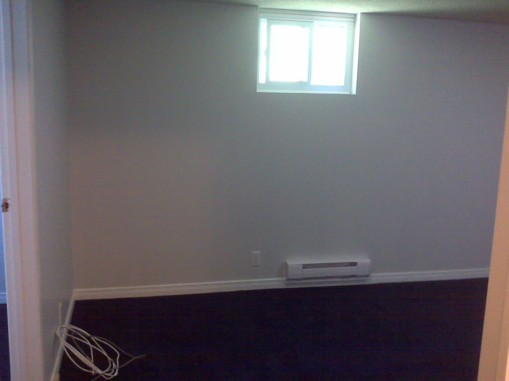

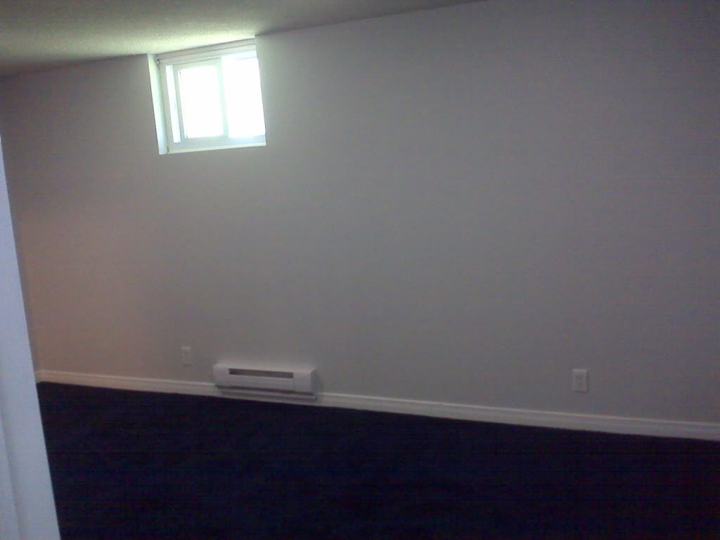

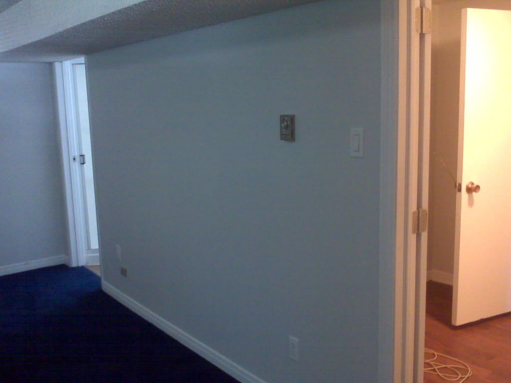

well finally got my own place with my gf, unfortunately it has to be into an apartment, but oh well. So now i need some help on where the best place to put everything, i dont have many options but i took some pictures for you guys to look at. ill post them, then tell you what i think.
walking into living room
facing 1 end, bathroom to the right
standing in bathroom doorway
standing in bedroom doorway

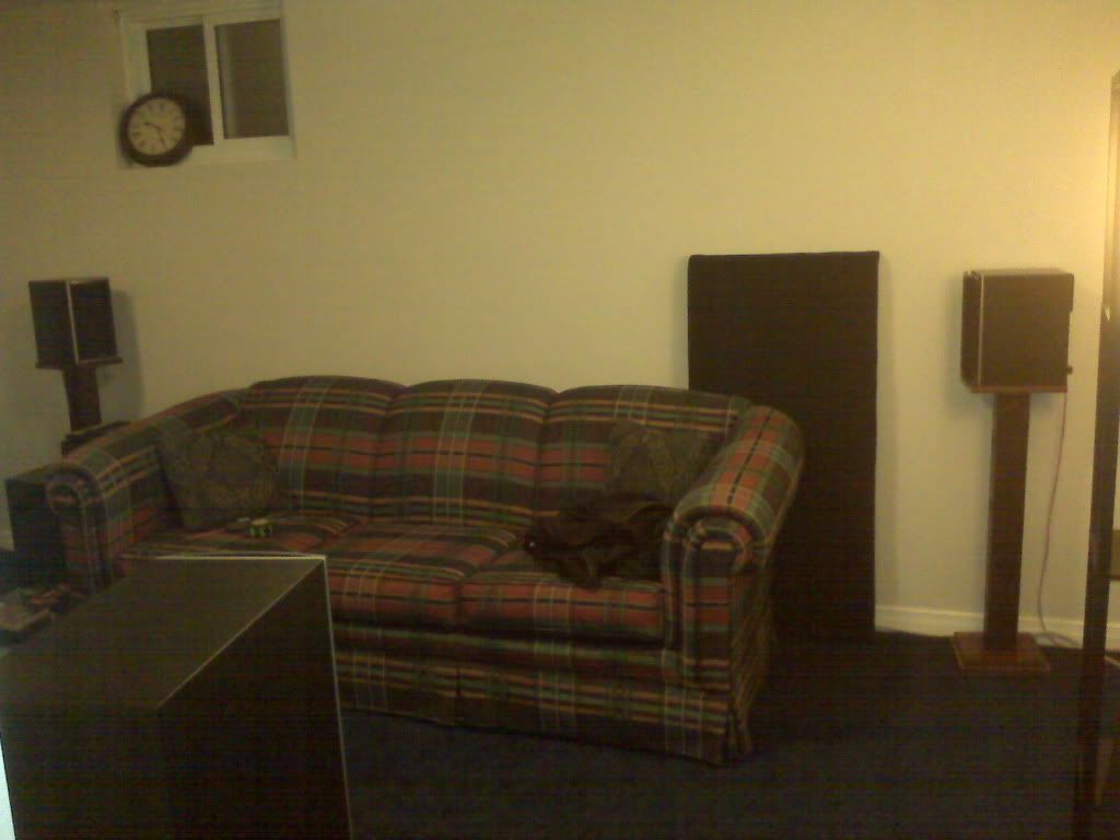

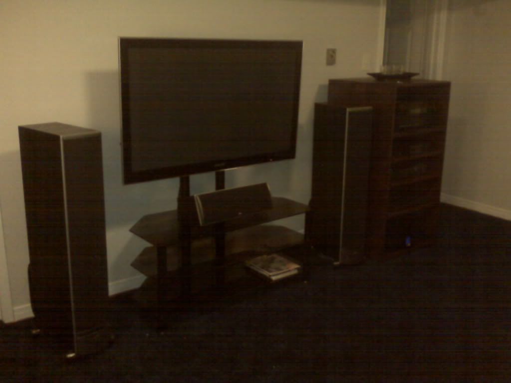

now here is my set up at home...
rack
rears
The pictures you see of the apartment, shows the living room standing at different sides, the side that has the window up top i think should have the couch along it, and along the left hand side before you go into the other room is where my computer will be, then on the wall between the 2 door ways is where i think my tv and fronts and sub should go. just dont know where im going to stick my rack (cant put in closets) and i need to know where to put my acoustic panels also.
I do not want to get rid of anything ie: rack, so i have to figure out some kind of way to fit it all in. the baseboard heat along that wall will not be used.

You've hardly listed any limitations or requirements, outside of the inability to use the closet space. Since we are in an acoustics forum, and not an interior design forum, it's pretty much the same old advice that I and others often give here. You can read my past posts in this subforum, and you'll see I'm retyping the same thing on a near weekly basis for the last couple of years.
If you want the best acoustics, you do not recreate your old situation. Instead, you want to:
1. orient the system lengthwise
2. start with 38% room length for your ears, doesn't matter front or back wall
3. even if you can't do #2, try your best to give yourself space from the back wall
4. you have space to work with, so please experiment with significant space between speakers and boundaries (both front and sidewalls). I'd say the GREAT proportion of systems out there don't have enough space.
5. If #4 is impossible, I'd put your panels on either the front or sidewalls. If front, directly behind speakers, if sidewalls, at first reflection points.
6. Give yourself full freedom in placing the rack. Mine is directly behind viewers, which generally helps with immersion as well. URC RF200 pack is $75, then you can put them anywhere, out of sight even. A 25 ft Mono hdmi cable is prolly $20.
I'm sure I forgot to mention other things, but there's my start for now.

ok well bad news, the wall to do it lengthwise, is a lot smaller then it looks in the pictures and smaller then i thought, it would only be able to have my tv there. so i guess im stuck with the way it was set up at home. i think i have a plan for everything to fit, just not sure on my rears as they will be either cramped up against my couch and close to your ears, or father apart, but one will be on a stand and the other ontop of my rack. so that i will have to deal with at some point. also, thanks for the help with reflections, i will have to do that once everything is set up, seems pretty easy to do! and the room is 11' wide same as my room now at home, that leaves me with a viewing distance of 8' away from screen to eyes, also my t.v is a 50". Im going to try to pull everything as far away from the wall as i can, and also may have to put my subwoofer some where different, maybe beside the couch, as i definitly dont want it near a corner, the last thing i need is to creat more boom lol, also, my hot lanlord that lives upstairs said she doesnt care about noise :), and said she will let me know if she ever leaves for a few days or something so we can watch movies loud :), so im very pleased about that, just hope i dont move or shake anything upstairs on her lol

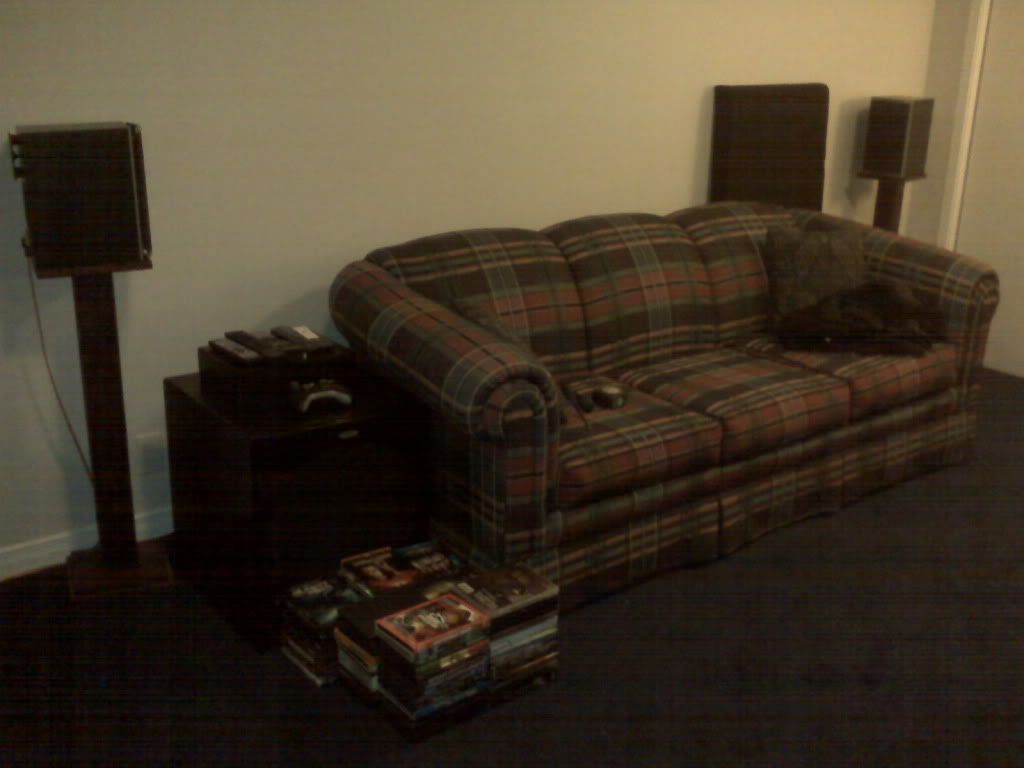

also, i have 2 shelves that i could put on the wall, that could get my rears higher up (what ever height i want) and that frees more space so i dont have my rears on my stands. question, do i fire them at each other, or at an angle? what height should they be at above my ear? and maybe how far from my ears should the be apart? seems like the wiser choice to make right now and frees up some floor space. p.s moving all HT furniture there tomorrow.

The other issue is that if you set up the short way, both you and your speakers will be very limited in terms of how far from a boundary they can be. This will require treatment behind the speakers for SBIR (Boundary interactions) and behind the listener. 2" panels behind the speakers could be somewhat effective. They're not going to be near enough to account for bass buildup from the wall directly behind the listening position.

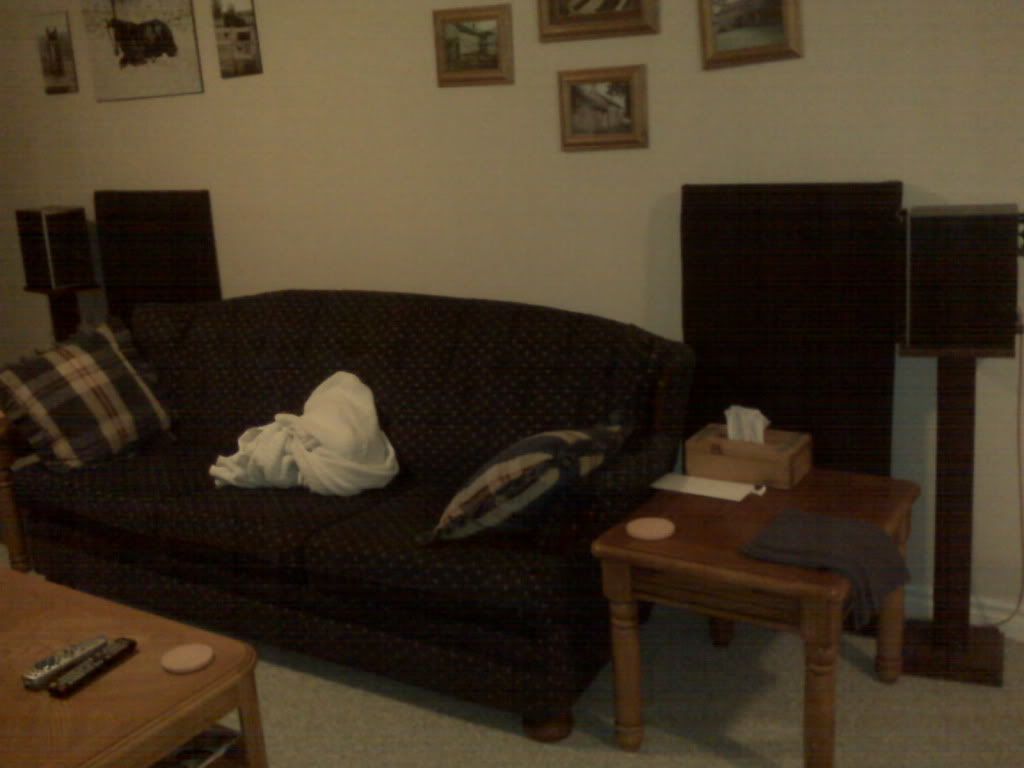

ok well we brought all my stuff there, and we could only find 1 way to do it to make everything fit, i know it isnt the best way. but we only had so much to work with. i will have to take a picture tomorrow night when im there. but the speakers are pretty tight to the t.v, but the rears are spaced out nicley, and i have the couch about 4-5" away from the back wall.
P.S what should i do about cables that are to long? ive heard not to wind them up and zip tie them. so what should i do, IE: speaker wire, hdmi cables, rca cable, and Power cables?
Hostility
Hostility

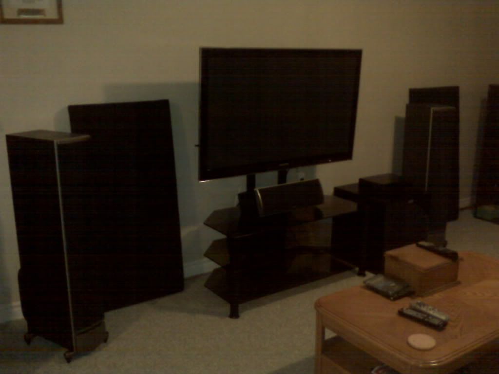

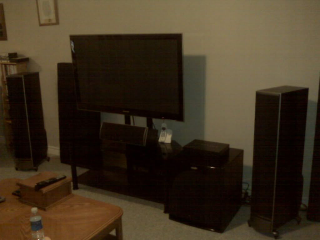

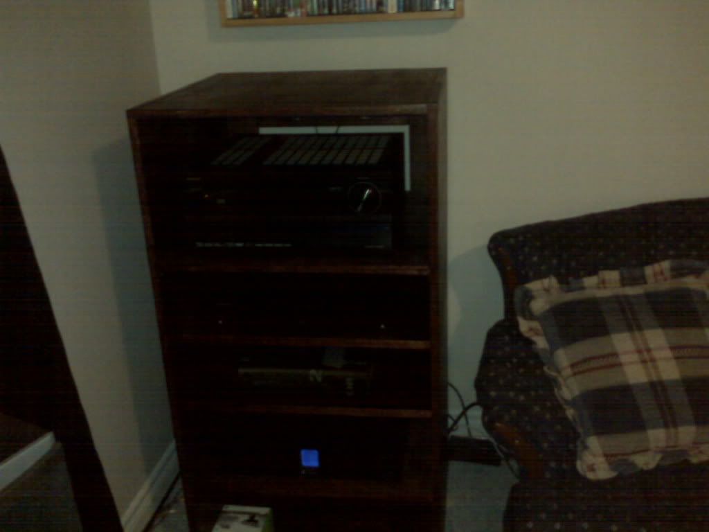

ok, here are some more crappy cell pictures, of how its all set up. all thats left is to run addyssey and put up acustic panels.
my head when sitting is 8 ft from t.v and roughly same from front speakers, and the rears are 5 ft from my head when sitting dead center.
subwoofer is sitting beside the couch. not hooked up as i wont be able to use it all the time, so i will only plug it in when it can be used. dvds on the floor untill i get the shelf on the wall

Is there a GRAMMA under your sub? Can't tell from the photo. It reduces vibrations that travel into the walls/floors; great for apts. Course poor placement and/or sheer volume will still rattle the walls.

no, but i have these rubber pieces, that are about 1" thick and really hard rubber, i was thinking of putting under it, would that do the same thing?

If you could move the rack away from the speakers that would help.
