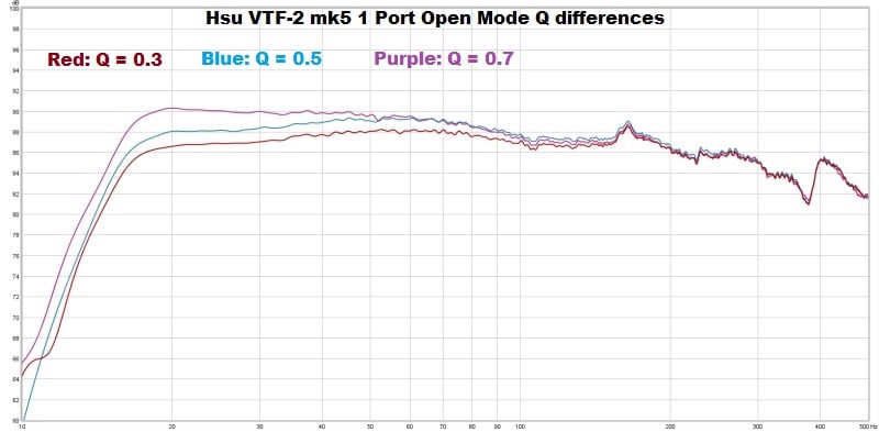

Be aware that the dB scale for the Klipsch is 5dB and the scales for the HSU is 2dB!
Klipsch RF-8000F:
HSU ULS-15 (sealed):
HSU VTF-2 MK5 (ported):

The ULS-15 mk2 response is not a traditional sealed sub response. It has a high-pass filter that makes it roll off at a more rapid rate than a conventional sealed sub behaves.
As for the low end of the RP-8000F, it may very well have too much bass for a small room, however, that can be solved with equalization. You can also just seal the port. It isn't intended to be used in small rooms though.
Again, if you find that your ported sub has too much low end for the room, you can always either seal the port or reduce the low end through equalization. You can always make a large sub sound like a small one but you can't ever make a small sub sound like a large one.
