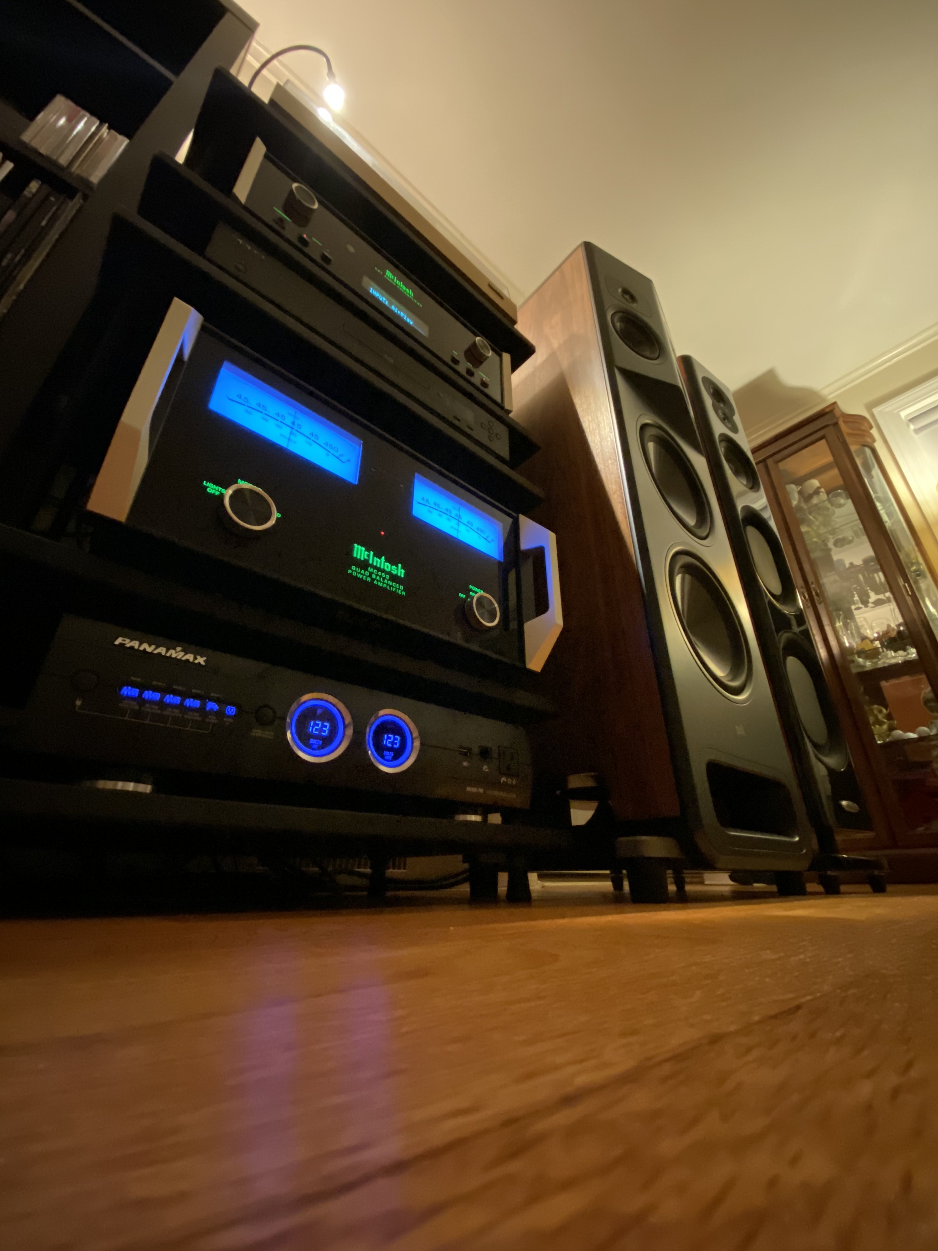

@shadyJ you can certainly do measurements. Just disconnect the SDA cable to get only the stereo mid/treble drivers. You may need to move the mic so its on axis relative to the inner active driver pair.
Also if you can please compare different Amps. I am having trouble recreating tHe SDA effect as much as I heard it in Polk demos using the same audio tracks. I think it maybe due to my choice of amps. I am using a McIntosh C47/MC452 and recently bought a Marantz PM-10 to try but get similar sound stage. The Mc is warmer sounding while the Marantz is crisp and brighter (not a bad thing).

@shadyJ I would suggest you speak to the speaker designer Scott Orth at Polk Audio. He mentioned to me the SDA signal is affected by amplifier topology. Single ended vs balanced differential. Per Scott the SDA was designed for single ended amplifiers. Most of the amplifiers I've been looking into to mate with my L800 are mostly the latter, I own a McIntosh Quad balanced and a Marantz PM-10 the others I'm considering are Yamaha S3000, PS Audio BHK and I'm not sure if the Anthem STR are balanced but It would be another I would consider.
Without going into too much detail, the derived SDA signal is only half of the wave from a balanced amplifier vs a singled ended amplifier where one terminal is typically ground and is only the signal return and you get full signal from the red speaker terminal.

I’ll need to ask Scott about what he is referring to. Nearly all amplifiers are not really single ended, they are typically a push pull design. But these amps are still ground referenced. A very few set of amplifiers are of a true differential balanced design. These contain two push pull amplifiers operates out of phase and have no ground reference. I could see this causing a problem, but I don’t believe any of the amps you mentioned are true balanced differential amps. The inked ones i know to fall into this category are ATI signature amps, the old Emotiva XPR amps, and some Class D BTL smps. I suppose some Class AB amps in BTL mode would also fit this, but not all. It depends how it’s done. I actually am not sure how Macintosh does the output of their amps since many use transformers. It’s possible the Macintosh Class AB design doesn’t reference the negative terminal to ground and in that case what you suggest could be an issue.
the amp I am using doesn’t have a ground reference. It’s a Class D BTL arrangement, so If what you say is true, I need to try a different amp. My Single ended amplifier is in need of repair, so I will have to do that ASAP to let me try it on these speakers. I guess a receiver is also always an option.
