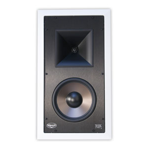

Hello All,
Some have been asking me about these,here is the info I have.
Hope this helps.
KL7800 & KS-7800 THX In-wall
Specifications
FREQUENCY RESPONSE:
80Hz-20kHz+/-3dB
POWER HANDLING:
150 w max continuous (600 w peak)
SENSITIVITY:
91dB @ 2.83 volts / 1 meter
NOMINAL IMPEDANCE:
8 ohms
CROSSOVER FREQUENCY:
2300Hz
TWEETER:
1” (2.5cm) Titanium dome compression driver with 9.6oz. ceramic motor structure
HIGH FREQUENCY HORN:
5” square 80° x 80° Tractrix® Horn
WOOFER:
8” (20.3cm) Cerametallic™ cone, cast aluminum frame driver
ENCLOSURE MATERIAL:
MDF Baffle; ABS Shell
ENCLOSURE TYPE:
Sealed
HEIGHT:
20.75" (52.7 cm)
WIDTH:
11.75" (29.8 cm)
DEPTH:
4.5" (11.4 cm)
CUTOUT DIMENSIONS:
Height: 19 in (48.3 cm)
Width: 10" (25.4 cm)
MOUNTING DEPTH:
3.688" (9.4 cm)
WEIGHT:
17.5 lbs (7.9 Kg)
FINISHES:
White plastic with texture (Brushed Aluminum Facia)
BUILT FROM:
2006
KS7800 THX
80Hz-20kHz+/-3dB
POWER HANDLING:
100 W Continuous (400 W Peak)
SENSITIVITY:
NOMINAL IMPEDANCE:
8 ohms
2130Hz
TWEETER:
Two 1” (2.5cm) Titanium dome compression drivers with neodymium motor structures
Patent-pending WDST™ Tractrix® Horn Array
WOOFER:
ENCLOSURE MATERIAL:
MDF Motorboard; ABS Shell
ENCLOSURE TYPE:
Sealed
HEIGHT:
20.75" (52.7 cm)
WIDTH:
11.75" (29.8 cm)
DEPTH:
4.5" (11.4 cm)
CUTOUT DIMENSIONS:
MOUNTING DEPTH:
3.688" (9.4 cm)
WEIGHT:
17 lbs (7.7 Kg)
FINISHES:
BUILT FROM:
2006
Engineered to bring real cinema sound to the comforts of home without taking up valuable floor space, the KL-7800-THX offers the ultimate performance in a hidden solution loudspeaker. It is designed for left, center or right channel use or wherever a monopole speaker is needed. Because of its THX® Ultra2 certification, the KL-7800-THX works well with multi-channel movie and music presentations playing up to reference levels in rooms of 3,000 cubic feet or larger. ... More
The KL-7800-THX is also capable of delivering the same high-output, low distortion signature sound as its traditional enclosure counterpart, the KL-525-THX. It employs an 8-inch aluminum woofer and a 1-inch titanium dome compression driver mated to a square Tractrix® Horn. This advanced horn design dramatically increases efficiency and allows the speaker to produce more output using less energy.
Featuring an integrated back box enclosure, the KL-7800-THX's response is both predictable and repeatable. Because this enclosure fits easily within the loudspeaker's footprint, the KL-7800-THX can be installed into new or existing construction.
Combine this dynamic loudspeaker with Klipsch's KS-7800-THX in-wall surround, KW-120-THX subwoofer and KA-1000-THX subwoofer amplifier to create a variety of THX Ultra2 in-wall system configurations. The KL-7800-THX can also be mixed and matched with the Klipsch THX Ultra2 traditional box products.
