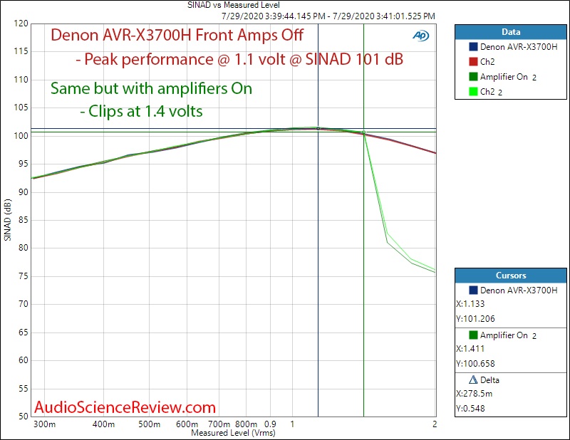

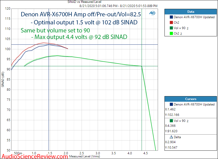

I was thinking on some of the x7xx series that Amir tested it was closer to 2V or was that just the optimal point? It's been a while.
Amir standardized on testing pre outs at w V RCA, and 4 V XLR. He did test up to 4/8 V occasionally.

Is there an equivalent with the amps enabled? Also wonder what happens in multich.
Yes, but he did it with the 3700. The preout performance for the 3700, 4700, 6700, 8500 are similar. Note that the "clips at 1.4 V is misleading. At preout 1.4 V, the pinternal amps would reach its clipping point, not the preamp.
I have never seen preout tests in all channel driven but it is highly unlikely the numbers would change much, not for preamps because the output currents are so low.

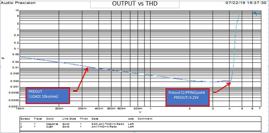

Denon and Marantz AVR preouts don't clip at 2 V, won't likely clip until it reaches 4 V. People get confused with the internal power amp clipping, and the resulting higher distortions would affect the preamp section because of the feed back loop. Such bad effects tend to taper off though so distortions would increase more rapidly after 2 V but tend to rise at a gentler way from there, until about 4 V when it would actually start to clip.
In the X3600H preview, Gene included the follow graph, he said was "output vs distortion plot courtesy of Sound United Engineering", note that the Clipping point shown is 4.25V.
