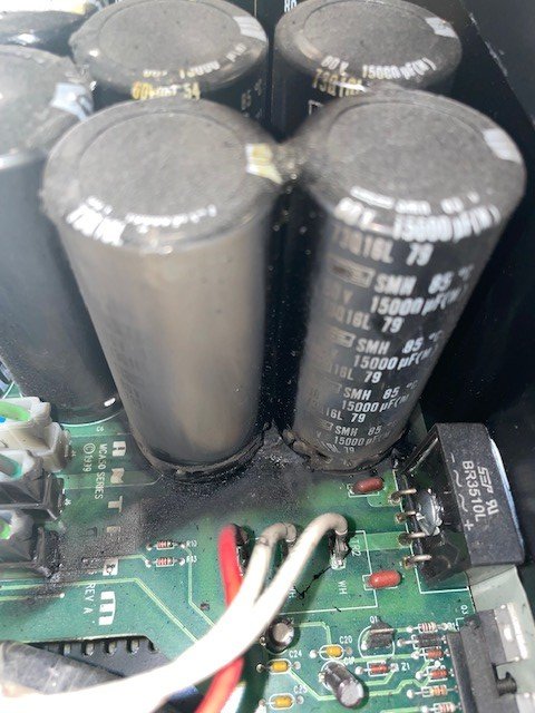

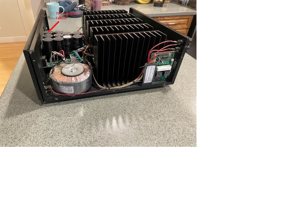

I appreciate the feedback! Below are some pictures showing the cap that failed. I am not sure what led to its failure. It happened at about 9am while my kids watched cartoons on low volume. There were no storms or apparent power bumps. I have this amp connected to a power conditioner (Belkin), along with the receiver. Some have noted that they would be concerned with the power conditioner...I am not sure.
View attachment 53381View attachment 53382
That looks like a robust power supply. I would be 99.99% certain that cap had catastrophic failure due to severe over voltage. I would bet your receiver was taken out by the same overvoltage.
I suspect the Belkin power conditioner is toast. You should NEVER connect a power amp to a power conditioner, only the low power devices, like preamps, processors, computers etc.
My strong suspicion is that, both your MCA 50 and your receiver are toast and beyond repair unfortunately. Caps have to be much older than yours before they fail catastrophically like that, even then it is unusual.
I hope your speakers are OK. You had better check them carefully before connecting them to anything else.
Is it really a MCA 50 or it is a typo, and did you buy it new? I have a MCA20 that is the two channel version so when I saw the picture of the burnt caps I found it strange that they don't look like those in the MCA amps.
Those amps were supposed to have 16,400 uf per channel so for the MCA 50, I would expect to see 10 X 8,200 uF 100 V 85 deg C caps. Anthem_Catalog_4.0:Layout 1 (anthemav.com)
You can see them clearly in the following video and yours look to have 10 X 15,000 uf caps.
Stereo Design Anthem MCA 50 Five Channel Amplifier in HD - Bing video

It's funny you say that, I looked at the same video preview picture you have noted above and wondered why those caps are 100V and mine are 80V...But in the anthem catalogue you have attached a link to it shows the caps as 80V at 10,000 UF. Mine are 80V at 15,000 UF.
My amp is (was) definitely an MCA-50 as you can see it printed on the circuit board on the picture above. I bought it used about 6-7 years ago and it has worked flawlessly since.
I can see 10,000 uf if they are 80 V rated because it would be about the same as 8,200 uf 100 V if the rail voltage was increased accordingly for the 100 V rated caps. The catalogue you referred to show 80 V 10,000 uf but they might have just used an old pictures from the MCA 5 that apparently do have 10 pieces of the 80 V 10,000 uf caps. That kind of things could happen so don't be surprised.
Yours are 15,000 uf 80 V that is a much bigger gap but it may be possible that Anthem downsized the power supply on the newer version of the MCA amps. Let's see what Anthem has to say about that, if at all..
To replace those caps will be costly, and there may be other damaged parts too and in that case you would be better off getting a new amp.
I also tend to agree with TLSGuy that whatever took out the amp likely have done so with the AVR or vice versa.
