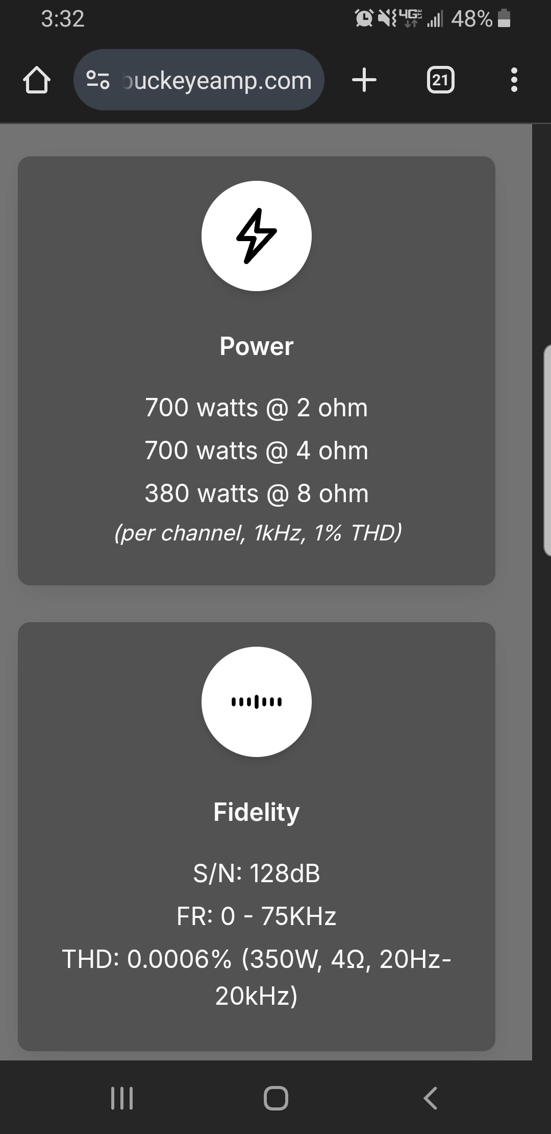

I noticed on the Buckeye site lists "Power" then "Fidelity". "Power" shows a THD of 1% and "Fidelity" show a THD of .0006%.
Yes, the modules are the amps. The way Buckeye list their power is typically, with power allowing for a higher THD.

I posted the picture from the Buckeye website because I'm not familiar with two THD numbers. One power and one fidelity. I've always seen just one. e.g. Rotel flyer stated all channels driven THD .06% for my RB-1080. So I was confused to see a THD 1%
