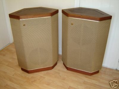

Allison Three Speakers. Anyone still have them or used to have them?
Explains why they fit exactly in the corners , now days subwoofers have replaced that job so main speakers can focus more on vocals and content rather then just bass. I’d definitely look into some modern speakers and maybe add a subwoofer if possible. I have them hooked to my tv for cable /movies etc , music shows like the voice etc .

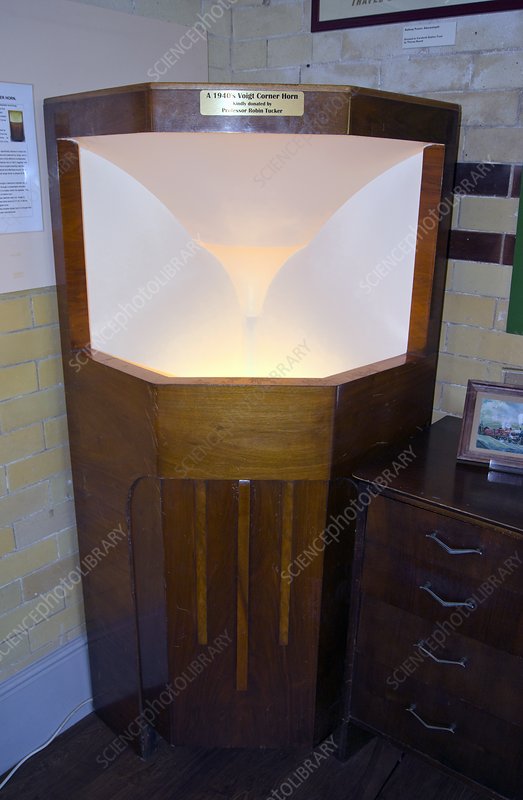

Yes, a corner location was common for the first 40 Years of audio. The Voight corner horn of the thirties was corner loaded. That was the world's first Hi-Fi speaker.
Its descendants are the speakers from Lowther, still in business and the world's oldest H-Fi speaker company.
From the US we have the Klipschorn
And of course Tannoy again UK
All the above are horn loaded speakers. Horns have to go in the corner, as F3 is directly related to the width of the horn mouth and so the corner becomes an extension of the horn mouth.

So those Allison speakers for their time they were nothing unusual

I had a pair of CD9's (bought twice and sold twice) and a pair of Allison Ones.
Those speakers were ahead of their time. The stage and image were incredible and their radiation pattern meant they weren't extremely fussy about placement. They might not have the bass or the crystal clear dynamics of more modern speakers but few that I've heard can sound as "3D" as a pair of Allison's. Not to mention the space you save by putting them against the walls.
Roy Allison solved problems 40 years ago that many manufacturers today keep creating for themselves.

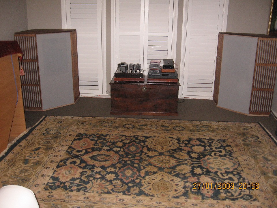

When I designed mine, the results were actually good, and I really enjoyed those speakers for nearly thirty years. Imaging was not pin point, but they filled the room evenly, had a really nice bass and were enjoyable. We used to enjoy listening to the Friday night Minnesota Orchestra live broadcasts on Friday evenings, by a nice roaring log fire in the cold North Dakota winters.
So the design is very much akin to designing for in wall. There is much greater bass reinforcement as the front of the bass driver has a significant degree of front horn loading.
The speaker is totally cardioid in radiation, as there is only forward radiation. The reflection pattern is a bit chaotic as you might expect, as the reflections are coming from boundaries at a 45 degree angle to each side of the speaker baffle. So you are not going to get outstanding imaging. Like every endeavor there are upsides and downsides. I can tell you they are far from the disaster that many proclaim them to be. I can tell you that if it is a music only system and you choose a good bass driver, you will not need a sub. Those speakers of mine in the picture had KEF B 139 drivers, and I can tell you that the bass was deep with great authority and they never lacked for bass in any way at all.

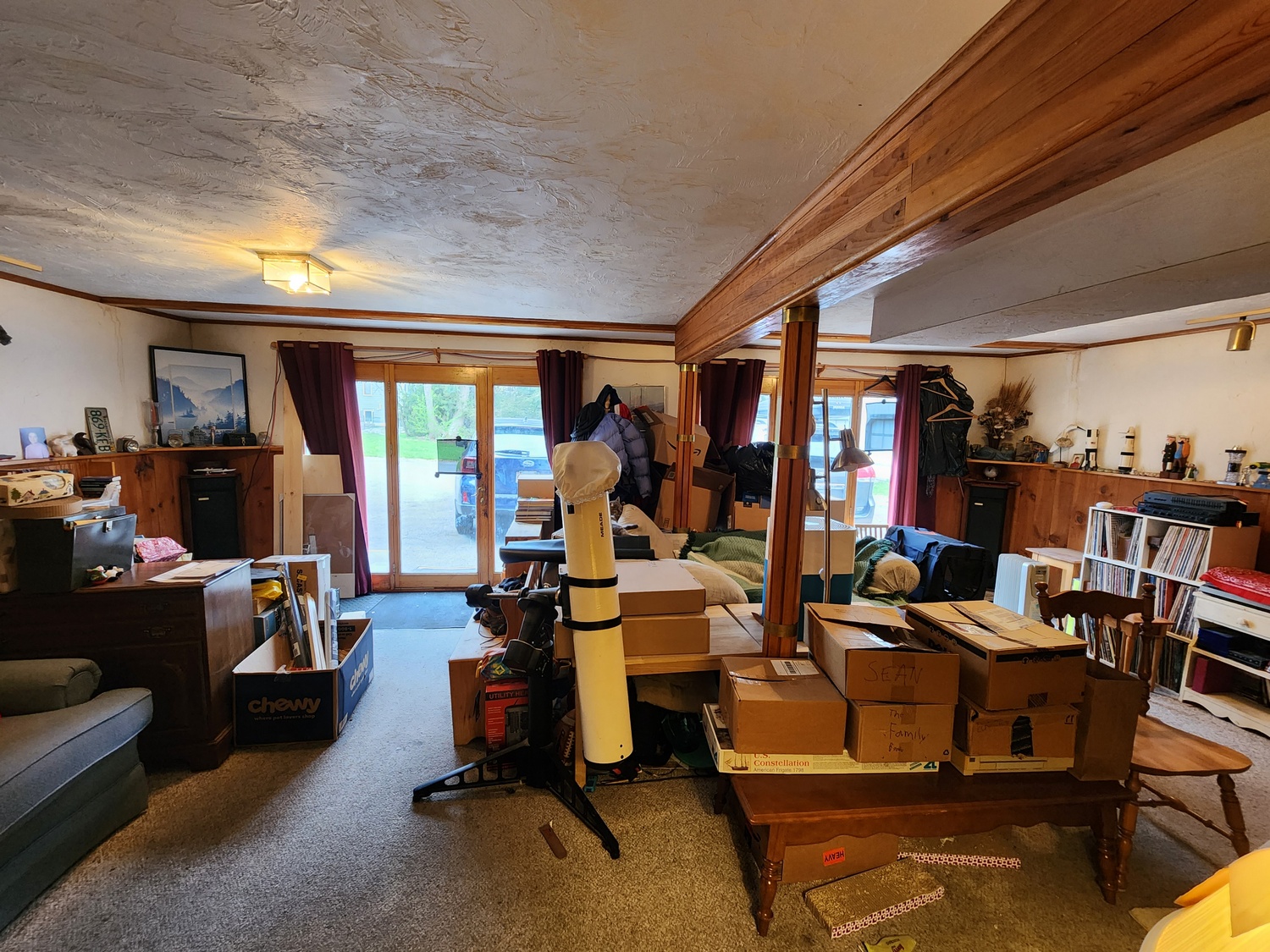

And here is my room. It's the basement and It's not just mine. Unforunately, stuff flows downhill and It's work just to keep the area around the speakers clear.
The room was once a 2 car garage but is now a finished basement. Only about 60% of the room is shown here.

The TV is out of view on the right side wall. It's impractical to use the stereo for the TV audio. Maybe I'll think about something better than a soundbar and subwoofer for the TV for the rare times that I stream concerts.
The room was once a 2 car garage but is now a finished basement. Only about 60% of the room is shown here.View attachment 61690

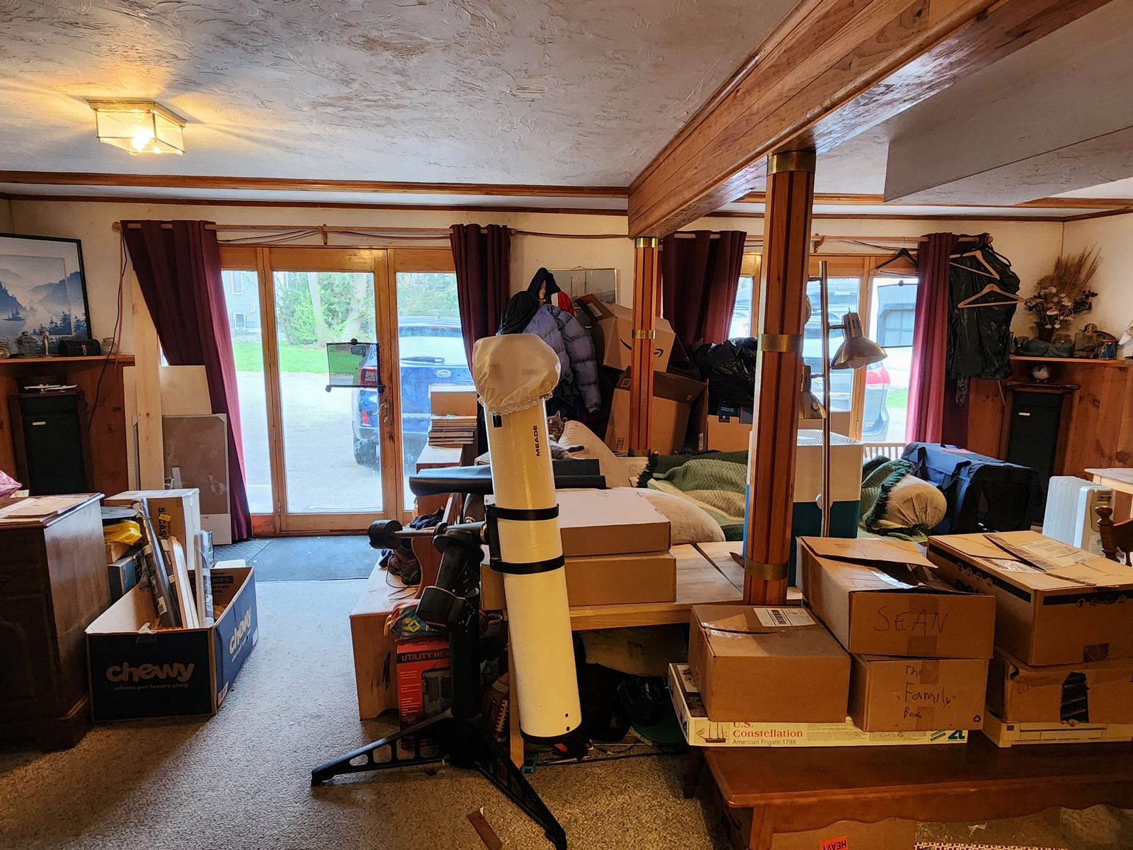

The whole room is yes. But that photo is also distorted. This is more like where I listen and typically the Carver isn't showing any movement in the levels. The two lowest lights are steady and no upper lights going on.

I couldn’t find the cat , we’re do you sit to listening to these speakers or do you crank them up and just listen from anywhere?
you could fit anything in that room even cinema-speakers .

The cat is on the shelf in the upper right corner.

I mainly sit at my desk. It's nearly centered as the pillars are the center. And I'm I estimate that I'm a little closer to either speaker than the speakers are to each other. I really don't need to crank them at all.
If I really want as close to perfection as I can I stand in front of the desk in front of a pillar but making sure the telescope doesn't block line of sight to the tweeter on the left.

That is actually a wooden blue cat sculpture. :)
The real cat is partly behind the telescope on the couch pillows below the light blue winter coat.
