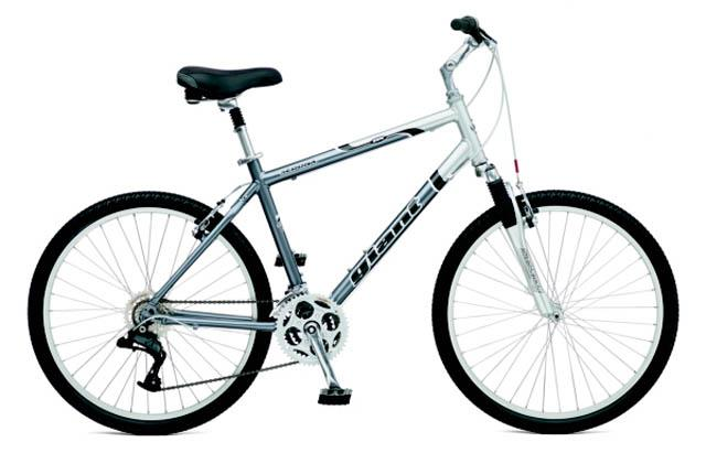

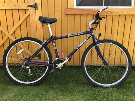

Lots of good brands out there- I had never owned or ridden a Giant- this one had some fairly cheap hardware, but since it's compatible with aftermarket parts, that's no big deal. I have to say that I definitely prefer it to the Trek MountainTrack 830 in many ways- it has a front shock, suspension seat post and it's lighter. I like the geometry more, too.
Neither of these is mine- I removed the stupid decals from the Giant, too. I don't like that kind of stuff and they weren't needed to cover a bad paint job. As it happened, I paid the same for them but didn't do anything to upgrade the Trek.
Did you have the dorky bikes like you pictured? Over cushioned seats and sketchy ways of increasing handlebar height? No wonder you don't notice crank differences :)
Giant and Trek and Giant IIRC are largely made in the same factories. Some other brands too. Frame quality is a good thing, and on lower price point bikes while not horrible not particularly attractive....it's the components that makes the big differences. Dirt cheap components just have issues. Upgrading is an expensive process, so usually your best value in a new bike is buying a decent component group for your use to begin with. Good design/options for accessories are important. Mostly for the new consumer it's simply too much info/overwhelming as to where the value lies.
If you would read the posts, I wrote that I had that model of Trek and HAVE the Giant model in the other photo. I'm not spending a lot on bikes- lost four to bike thieves in the past and it didn't matter that they were locked or in a locked garage, either. I'm also not going to buy a high end bike in order to insult anyone else or feel like I'm better than someone else.

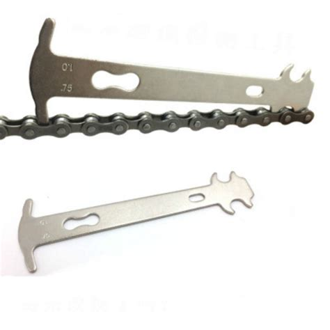

I use a chain gauge- it didn't fit and I compared the existing chain with a new one. Cleaned/lubed and quiet.

The chain gauges are okay, but removing the chain and hanging it and measure it over the length is a bit better IME. Bearings don't particularly need to be "sealed" (which of course aren't truly sealed anyways...but can help with ingress of crap). The sealed cartridge bearings are pretty common now, but some are better sealed than others. I take it it was a cartridge style square taper bottom bracket? Those are pretty much gone except on the cheapest bikes, outboard sealed cartridge bearing style cranksets are more the norm now (even with fancy ceramic bearings if you want), as well as in headsets and hubs.

When I wrote that I compared it with another chain, they were hanging and if I didn't have the specialty tools, I bought them- not a fan of "I can get this to work" unless it's something like a hex nut/bolt. Also, comparing it with another part implies that the reference is within spec, and a quality gauge can remain 'in spec' as long as the reference chain isn't used on a bike. WRT sealed vs loose or caged bearings, sealed are usually more precise and because they don't allow that crap to enter, they last far longer. Yes, the BB is square taper, but as I wrote originally, the BB bearing is sealed and the bike is from 2001-2004, so a lot has changed since then. My Trek road bike's BB is a caged bearing, but that one is from 1984. I'm surprised sealed bearings took so long to be used for axles- zero adjustment and no need for someone to know how to set the preload.

ps And for hanging chain you can use a good tape measure/ruler....
