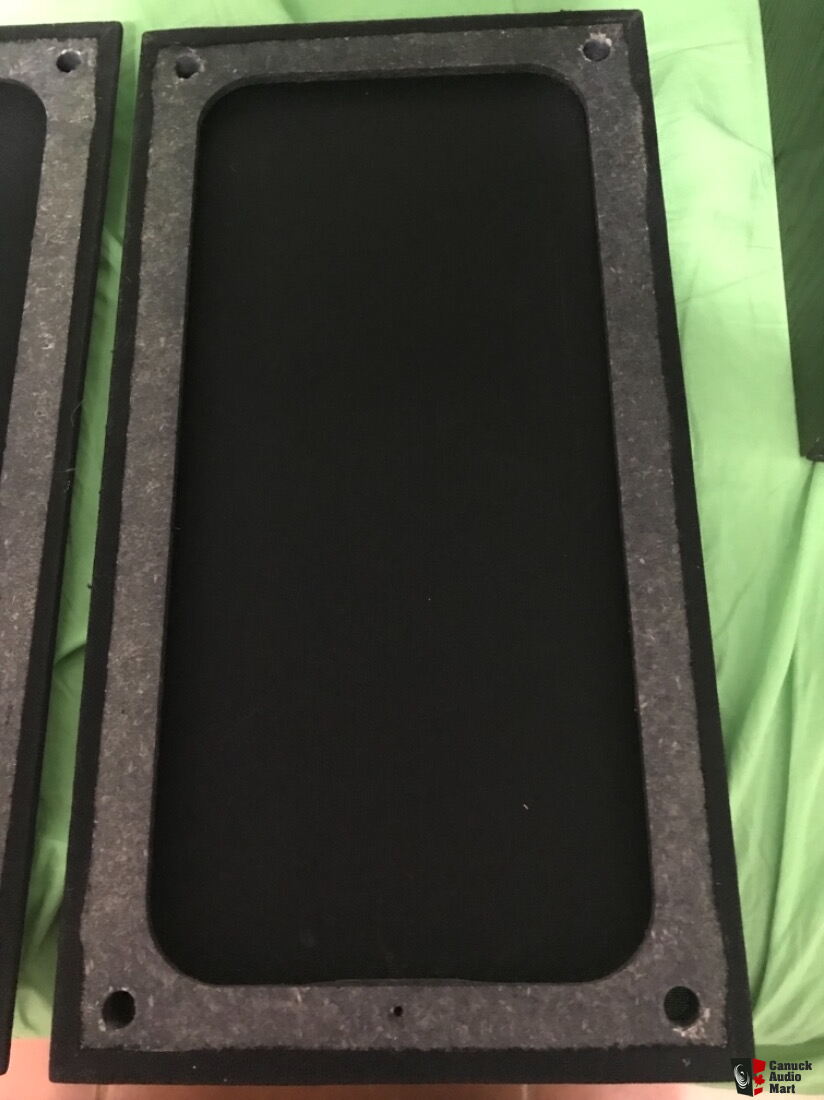

Found a back view of the grill.. Looks dirt simple.
Looking at it again, there must be two wooden pieces that make up the grill. The bottom one is totally covered by the grill cloth and then the mounting piece which sits on top.

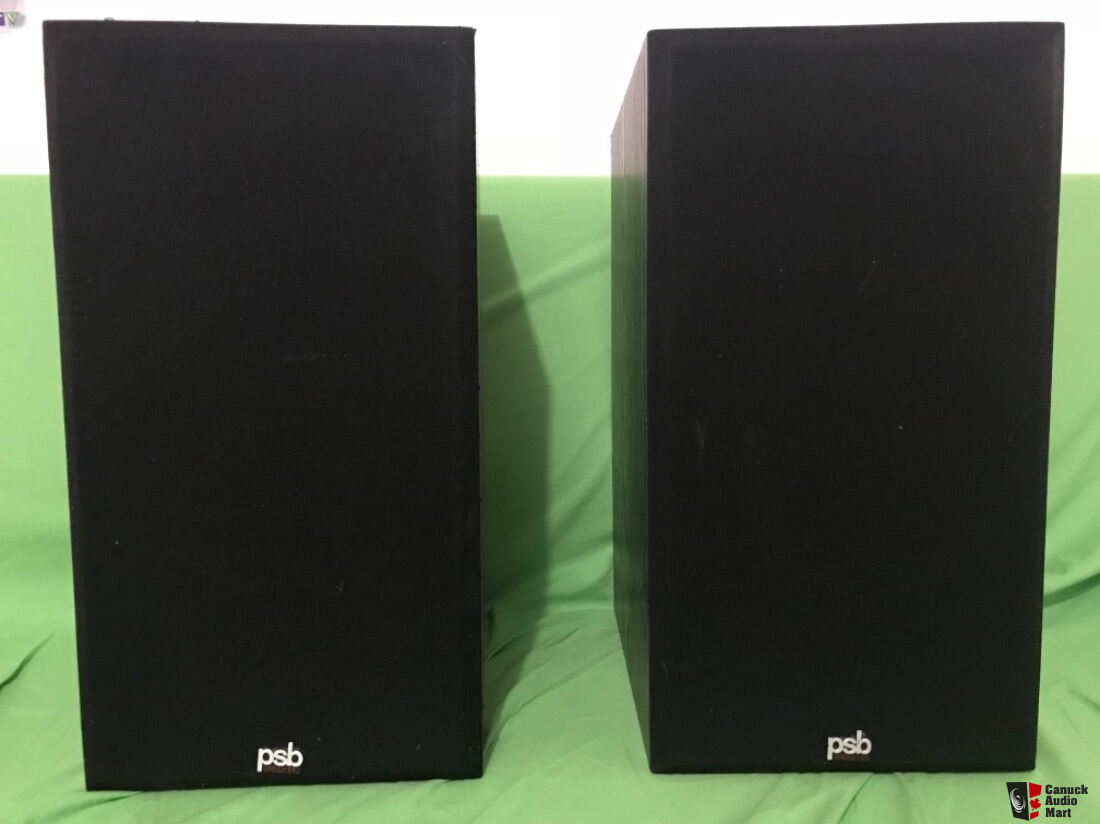

I want to try and duplicate the bevelled look of their grill as shown below.
There is only one piece after a closer look and the grill cloth is wrapped/glued across it.
If it's just a bevel (or chamfer), it can be cut on a table saw or router. I would start by shaping the edges before cutting the opening. That would prevent the edge pushing in when it's being cut- this would be more likely to happen if the edge is cut with a router, but it can happen with a table saw, too. If you have access to a router, a template could be made of thin material (plywood, Masonite, whatever), held on with screws where the holes are located at the corners and the opening could be cut roughly with a jig saw (inside of the line) and cleaned up with a flush cut router bit, using the template as a guide.
3db
3db
Thanks Ken and highfigh. :)
It would make sense to bevel the wood before cutting the driver openings. Lot more sturdier. Also, when I drill the holes for the mounting knubs, I will drill them larger then they have to be and glue in a rubber hose in the hole so that there is more friction to hold the grills on.
