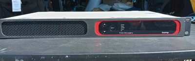

You can also pick up audio DSPs which will do a great job of handling all of your splitting/mixing needs for the gear.
Audio DSPs aren't necessarily for the faint of heart for setting up, but they allow for mixing of different sources and you can add microphones if you wanted to (for karaoke) and full audio management. eBay has a ton of used models available for well under $100 which used to cost $2,000+ brand new...
The model above has 12 inputs and 8 outputs which allows for a ton of flexibility and is industry leading technology.
Learning curve is a bit steep, as I said, on these types of products. But, they perform very well and have a ton and a half of flexibility.
