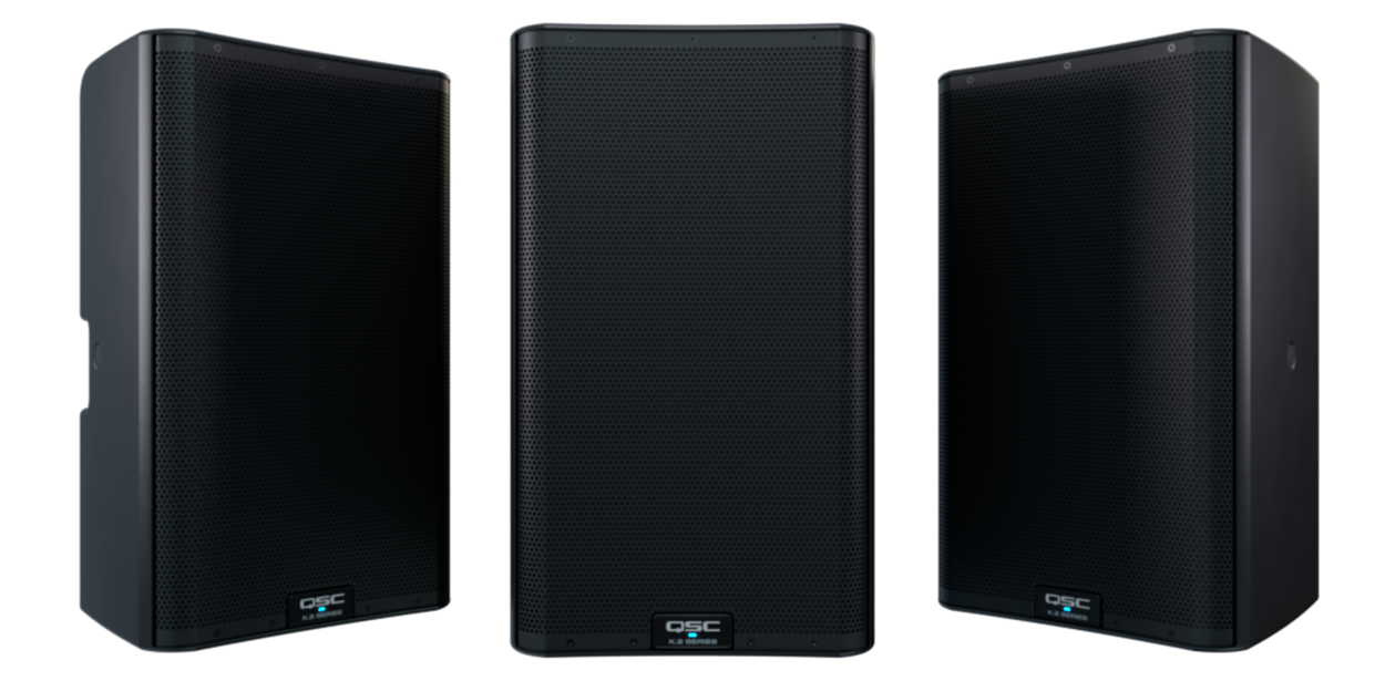

I would be looking at some QSC K2 speakers run in 'monitor' mode, and a processor like maybe a Marantz 7705. For subs, I would be looking at some Paradigm Defiance X15s.

JBL Control speakers are not very good. They are used extensively in commercial installations because they are cheap, not because they sound good.
I will agree with others here. What CLUB have you been into which uses in-wall speakers? If your answer is "NONE!" then congratulations, you can't have it in your home either.
You could put in 500 in-wall/ceiling speakers and you aren't going to get the output or response that you get from proper speakers that are used in clubs. The reality is that you are much better served by providing two systems. One for high quality audio for surround sound, which is designed for precision, and another set of speakers which are designed to produce SPL levels that are more akin to what you experience in a club. These types of speakers tend to not perform well at lower levels and do a very good job of delivering high sound levels with good quality and very good endurance (they won't blow up).
So, I might consider a decent set of in-walls/in-ceilings in the appropriate spaces for your surround system, then roll out the 'loud' speakers when you want the room to be a club.
Then get two or four of these...
or these...
I think I put in a set of the KW153's predecessors into a home and I can say that they were exactly the solution they were looking for after having 8 in-ceiling 8" 3-way speakers plus 2 10" in-wall subwoofers left them feeling quite lacking.

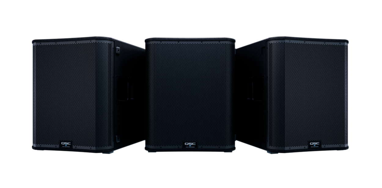

If you want more bass response, there are also matching subwoofers...
This is the difference between home theater, which gets loud, but sounds excellent and can play at reference levels politely, and club speakers which get well beyond those levels and feel much more like a proper nightclub. I have yet to see any home theater speaker which can reach the sound levels of club speakers at anywhere near the cost. Shure, you can get some B&W 801s to do it. Some Meridian DSP8000's will do it as well. But, you are suddenly spending 10 times your budget on a single speaker, which just doesn't work.
Be aware, the QSC speakers I linked above are active, very large, and will need to be 'stored' when not in use if you want to keep the room clean. I'm sure you have planned a proper storage space for your basement, so storing some proper speakers to meet the demands of the room will be fine.
The final thought... This is not a minor consideration what I just laid out above and may not be ideal for what you were hoping for. That's fine. Don't buy them right away. Just understand that after 20+ years of doing this, I've learned that there is a huge difference between a club sound and a home theater sound and people that want a room that sounds like a nightclub are not happy with in-walls/ceilings. But, if you WIRE for freestanding nightclub style speakers when you are building out the space. You can buy them later. You can run XLR cabling, or if you want passive speakers, you can wire 12 gauge speaker wire to a few locations around the room, and you can just buy the equipment for it at a later date. But, plan now! Wire now! The wiring is cheap, but after the walls are up and you can't put wires in place anymore, then you are in real trouble if you want to add wiring later on down the road.
But, if you want that club sound, as others have said, you aren't going to get there with in-wall speakers as has been my experience.
