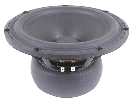

The woofer it uses seemed to be unique for what it does.
Back home, now... curious what you are commenting on here. Which BMR, the Monitor or Tower? (Ultimately there are 3 different Woffers, involved, the older Monitor uses a ScanSpeak Driver, the newer Monitor uses an SB Acoustics Ceramic Driver, and the Tower uses the monsterously awesome 8" Scan Speak Revelator.
All of these are good quality Drivers that perform very well at what they do. ;)
ryanosaur
ryanosaur
The Tower with the 8" Revelator.
ScanSpeak is a very reputable company with a long history of developing and building High End Drivers. (The Skaaning family also founded Audio Technology.)
That 8" Revelator is well suited to Transmission Line loading. It will also perform well in a vented box.
I'm pretty certain this is the right one here:
Yup that is what I looked at :)
