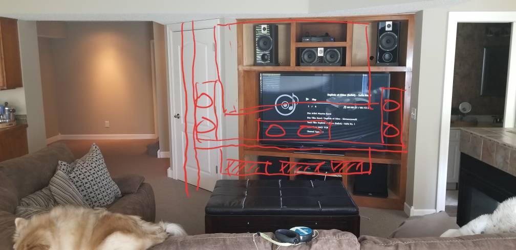

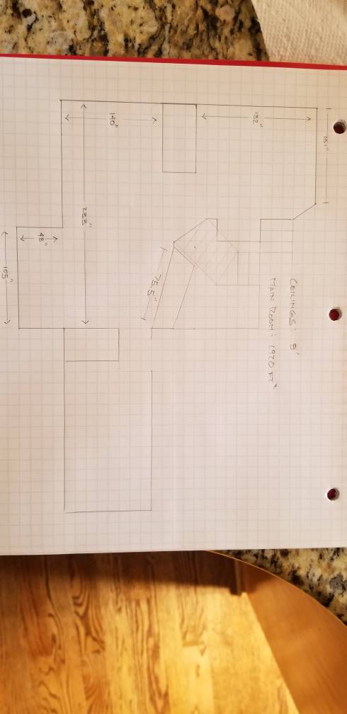

My bad, I didn't include any real detail on the room.
This is our new basement. The built in is a huge problem. I'm working in getting a carpenter to look into deleting the built in, pushing the left wall out under the stairs, and doing a clean single shelf with the TV mounted on the wall.
Main room is 1920 ft^2

Also, heres a rough sketch of the layout.

I go with either Song Towers at $2000/pair or Song3 at $3200/pair. Because you already have two 12" subs, I'd go with SongTowers. The larger and more expensive 3-way Song3s go deeper. The ST was Jim's bread & butter speaker for over 10 years. More recently the newer Song3 series has probably sold better.
I had a pair of SongTowers for about 9 years. Read my impressions of them from 2007. I loved them then and still do now. (Three years ago I stepped up to Salk Veracity ST speakers.) SongTowers were also reviewed, highly favorably, by others including Audioholics, Enjoy The Music.com, and The Absolute Sound. See the review links on the SongTower web page.
Check out what size foot print each of those require. The plinths have a bit larger footprint than the speaker towers.

My first, and larger, problem still is being sorted out. There are no towers if the front sound stage isn't expanded.
I'm struggling with find contractors to take on my project. It's not worth enough for them to do the work. I've had x3 tell me today that they won't take the job. That and the guy that was supposed to be coming today cancelled this morning.
All dressed up, with no place to go.

Nobody said you have to use the existing cubby. ;) Perhaps you can craftily remove partitions, wall mount the tv in the little nook, employ some standmounts outside of the nook? :)
But then again, I’m a function first kinda guy. If it doesn’t function, re-form it! That “built in” does not function. Who ever built that doesn’t believe in life. :p
The design of the built in, combined with the asinine in ceiling placement makes me wonder what I've gotten myself into. With poor choices like these apparent, the previous owner is more than capable of creating more land mines for me to discover.
As far as pulling everything out, believe me, I've thought of that. The problem is that they will stick out into the main entrance to seating area pretty far. This is something I'd be ok with as I work the redesign problem, but my favorite lady will not be so forgiving.
The art of compromise. ;) Let her pick the finish of the Salks. You’ll have four months to fix the cubby while they are being built.:D
