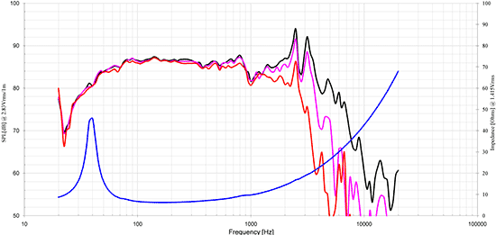

Now I can answer that question. Audio signals are AC electric signals, not DC. The impedance of any speaker is not constant, it varies with the frequency. So you cannot plug a single impedance value, such as 8 ohms, into a formula and calculate the roll-off frequency of an inductor. You have to know the speaker's impedance around the range of the intended crossover frequency.
Here's an example for a typical 8" woofer, a Peerless SLS 830667 woofer. See the blue trace for the impedance (the impedance scale is on the right side of the graph). It has a minimum impedance of 6.2 ohms. There is a peak at the woofer's resonance frequency, followed by a zone, roughly 100-1000 Hz, where the impedance is fairly constant at under 8 ohms. Above 1000 Hz, the impedance rises in a non-linear curve. To properly calculate a cut off frequency for an inductor or capacitor, you must know the impedance at the frequency intended.
