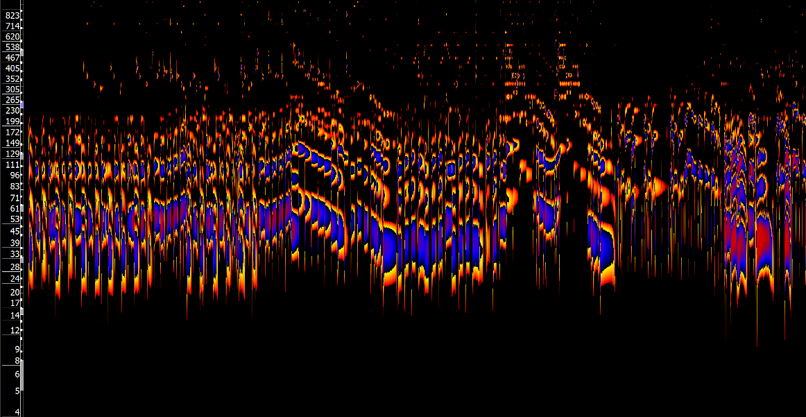

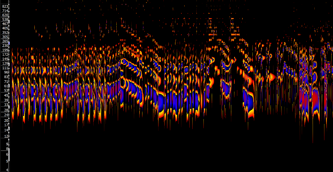

One particular track is Flight of the Cosmic Hippo by Bela Fleck and the Flecktones (jazz). The bass is deep from the start, and the bass run in the middle of the song extends waaayyy down (string bass that sounds amazing).
It's smooth and fairly deep, but not very strong. Here check it out, I ran it through an analyzer, along with one of my songs that I know digs really deep. What we're looking for is the color red. The more red it is, the stronger the bass.
This is Flight of the Cosmic Hippo.

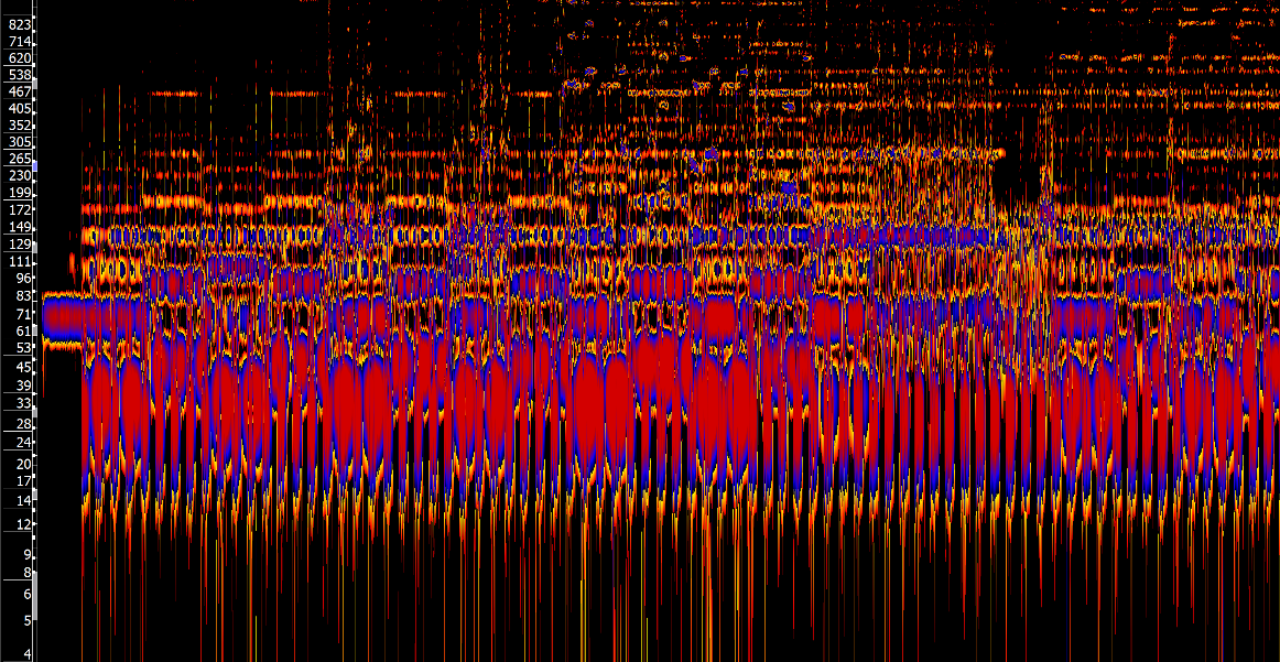

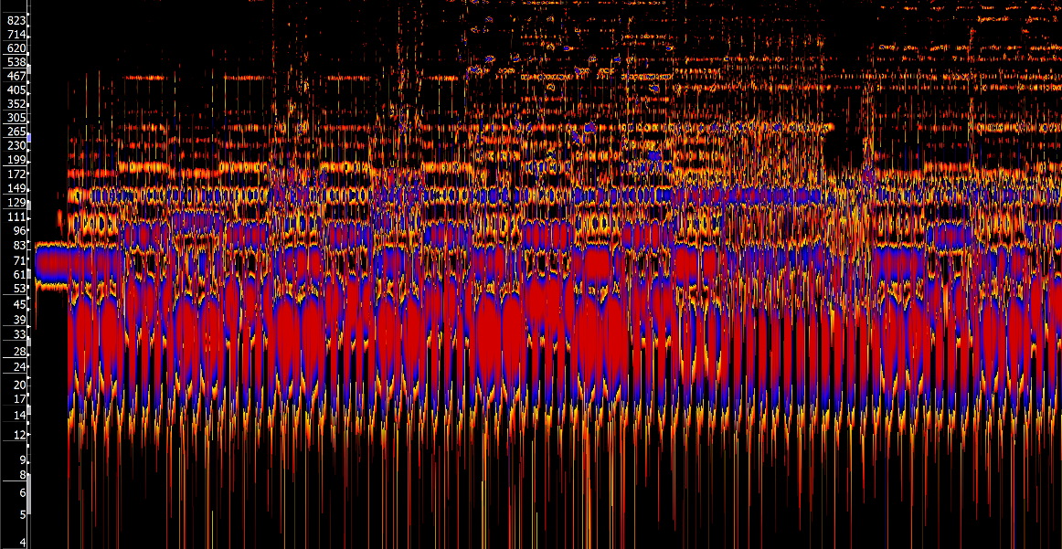

There's some energy in the lower octaves and it does dip down to the mid 20s, but not with much authority. The chart below shows what deep, strong bass would look like.
Pogre
Pogre
So, Cosmic Hippo does not have a lot of bass energy to start, and your sub's f3 is 29 hz. So a good portion of what bass is there dips below your sub's capabilities. So between your sub and the song you're using to test it's not surprising you feel there's something lacking.

Ohh.... you're kinda close? Not really tho, lol. A very good guess, knowing me tho! It's "Punchline" by Chevelle. He's gotta be using an electronic kick pad for that song.
