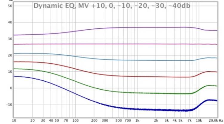

Fwiw, this is what Deq looks like on paper with different MV levels.

Btw. Nice job on those. I’ve seen you lost them before. Always liked em. I’d be curious to see what the same exact sweeps look like at -5 and -40 since it applies more db at lower volumes. I had some one time but that laptop is TU.....

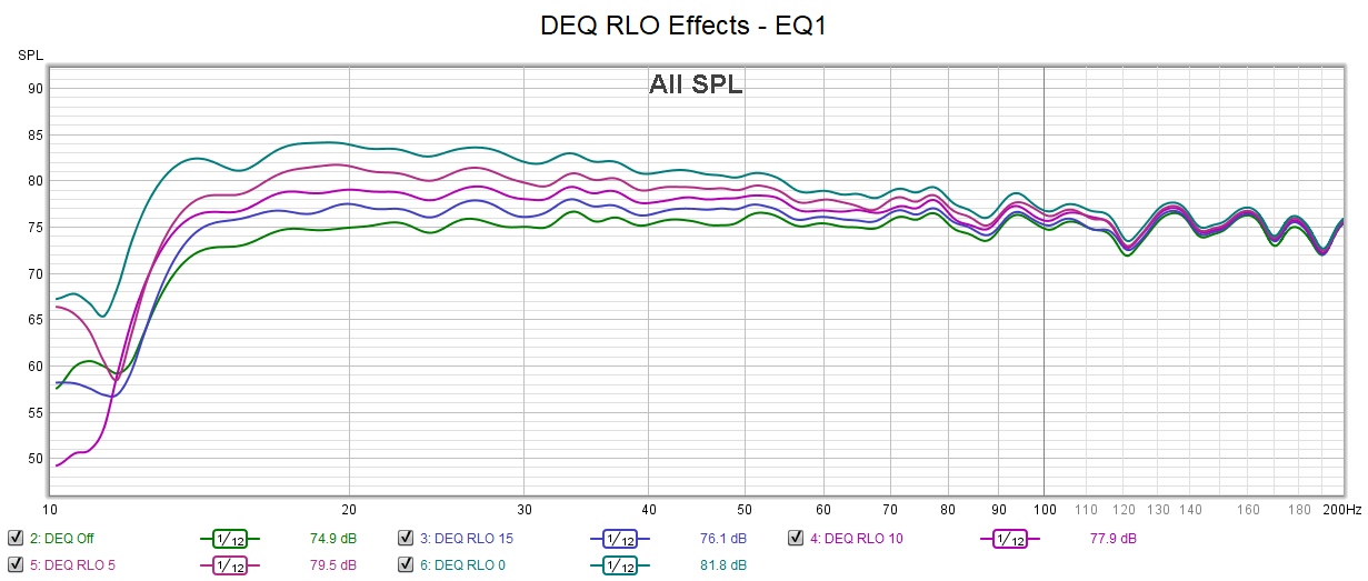

I took some sweeps a while back too, just for this purpose! I labeled each sweep so you can see how the different RLO settings shape the curve.
Going by them -10 does honestly seem like a good middle ground. I guess if I ignored DEQ and just raised subs a bit, either way I could be losing something. -10db offset does seem like the best option. Although I do dread the surround boost DEQ has when I get my Bronze FX surrounds.
