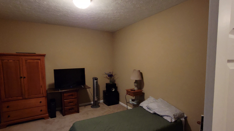

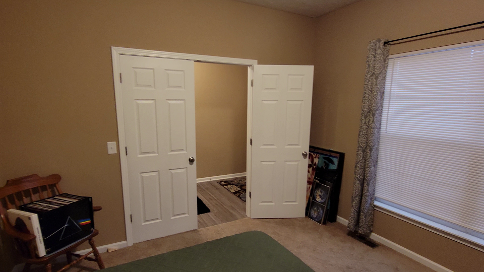

I will be starting with the spare room that measures 11'-8" x 14' x 9' High.
Next, I will clear this room out, paint it. The following are renders I did to plan out the space. A full 3D walkthrough and narration of the room is in the video.

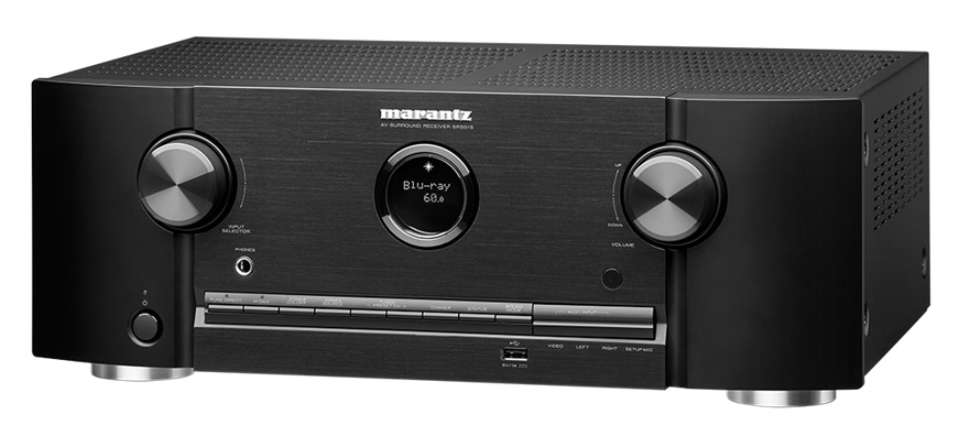

For now, the AVR will be the Marantz SR5015 because it offers 100 watts into 2 channels and provides all the necessary high res streaming options. Plus it has a phono input.

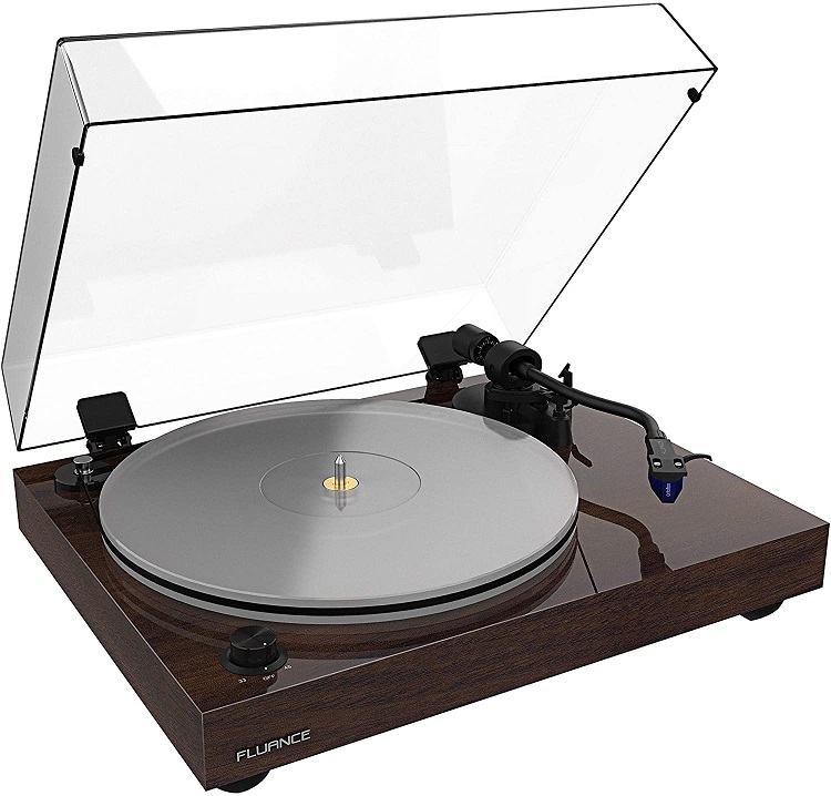

My turntable of choice is the Fluance RT85... at least for the moment. It's been getting nothing but positive reviews in its price range.

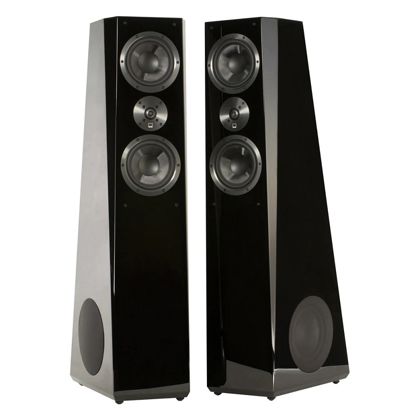

The speakers might be the SVS Ultra Towers. I wanted these a few years ago when I was designing my home theater but the Klipsch RF7 III's and the Reference Premier line beat them out due to Klipsch's lower cost and better sensitivity. If you watched the video, you'll understand why I'm moving away from Klipsch for now.

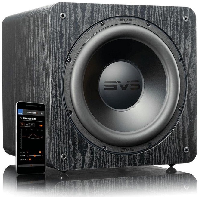

I'm expecting to also buy subwoofers for the room. I want to feel the bass in my chest from the kick drums and to do that, I have to get away from the ported subs I'm so use to. I typically build my own subs but I've always wanted some SVS and will consider a couple SB-2000 Pro's for this project.

I also would not put the subs next to those speakers. One of the main advantages of the SVS Ultra towers is that they can play deep bass very competently. In fact, the SB-2000s probably wouldn't have much advantage over them if you give the Ultras enough amplification. I would place them elsewhere throughout the room where they will yield the flattest overall response. I would not high-pass the speakers. I would equalize the system for the overall flattest bass response. Dirac's bass control system would be really useful to you at this point.

I’m curious about the comment about going to seal Subwoofers because you want more kick then the ported subs that you are used to.
I didn’t know that sealed subs kicked harder.

I wouldn't go for the SVS Ultras if you want subs. They have 8 inch drivers for bass already and largely the extra cost of them. If you want subs, maybe just go to the Prime Pinnacles and then add subs. With the Ultras, unless you set the crossover very low, you'll probably not even get use of those 8 inch drivers. That means you could have more money to get better and bigger subs. If you want to feel bass, go bigger on cabinet volume with modern drivers and design. Monolith is making some really great subs right now. HSU Research deserves a look too.
Are you completely sold on SVS towers? You have a lot of options in this budget range that are excellent, better than SVS and lots of beautiful cabinet options.
For the same budget, you could go for some really nice end-game speakers, like some Philharmonic BMR's or Salk SongBirds, with beautiful finishes of your choice. And compliment with good subs only if you want to.

If anyone's still watching, I'm in the process of trying to get the Philharmonic BMR towers in piano black from Dennis Murphy right now. Apparently, all April pre-orders are sold out and he's not 100% confident the next batch of pre-orders slated for August/September will be on time. These are tough to get!

The BMR towers will be a legit 2-channel and 2.1 option! Very worth the wait. I know we talked about this before. ;) The Towers are very similar in performance to my Phil3s.
On their own for most Music, these will perform astoundingly well. A good Sub for Organ and deep electronica is likely necessary.
Dennis Murphy and his partner have had to deal with epic shipping problems for pretty much all their gear, from the cabinets to the drivers.
I think you will be blown away.

Everyone seemed to squash the SVS Towers right away. I assume the Marantz SR5015 is acceptable. I honestly can't see why not. I'm creating a modest listening room that sounds good and I know the Marantz should sound good at a fraction of the price of tubes and separates and all that other foo foo.

Marantz should be fine, especially just driving 2 channels. If you were to ever want to Amp them, Hypex and Purifi seem to be very good options. (I'm waiting on my Chassis from Ghent to finish my NC-400 Amps... of course Shanghai locked down 2 days after I placed my order. :rolleyes: ) Regardless, I think you are on the right path. :)
(FWIW, I didn't join the party, but agree that the Ultras wouldn't necessarily have been the best. :p So good choice! :D )
