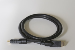

And they both have HDMI thing and my reciever has two HDMI inputs and one output so I guess I can use HDMI cables for it.
One more question.. do the HDMI wires have to be as expensive as they are at circuitcity? Like about four feet at 150 dollars! I have found cheaper ones online but does that make a difference in quality?

For good quality HDMI cables at a good price try www.monoprice.com
The whole HDMI thing is still being worked out (ver. 1.3 blah, blah, blah). Just try to stick with the heavier gauge wires if you have a run over say 10 feet or more (22 to 24 ga.). In case you didn't know, the lower the gauge number, the bigger (heavier) the wire. Hence, 12 gauge wire is larger than 14 gauge.

If you're lucky you might find HDMI cables at your local WalMart store. The ones in my area sell them for around $20-$30 depending on length.

Definitely take a look at www.monoprice.com for all your cabling needs. If you aren't running wires behind walls or anything crazy, then if you decide to upgrade later on you can. But, in my experience, the cables from Monoprice are transparent when compared to other far more expensive brands.
Yes, I've tried the $200 Monster cable, then the $10 Monoprice cable and no visible difference was detected. So, why spend 20 times as much?

People here don't seem to much recommend buying off e-bay, but I got my 25-foot HDMI cable off there and it works great for like $50. I got the heaviest gauge I could find. I compared it to an expensive 6' HDMI cable I borrowed from my more HT-savvy friend and noticed absolutely no difference between them in picture quality.
