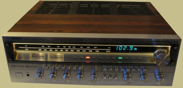

I can still remember when Onkyo made really good 2-channel stereo receivers back in the 70's.
Their amp sections were generally good and so was their reliability.
It's sad regarding their quality today.
A friend of mine back in the day had one of these, a TX-8500
What a beautiful work horse it was.
