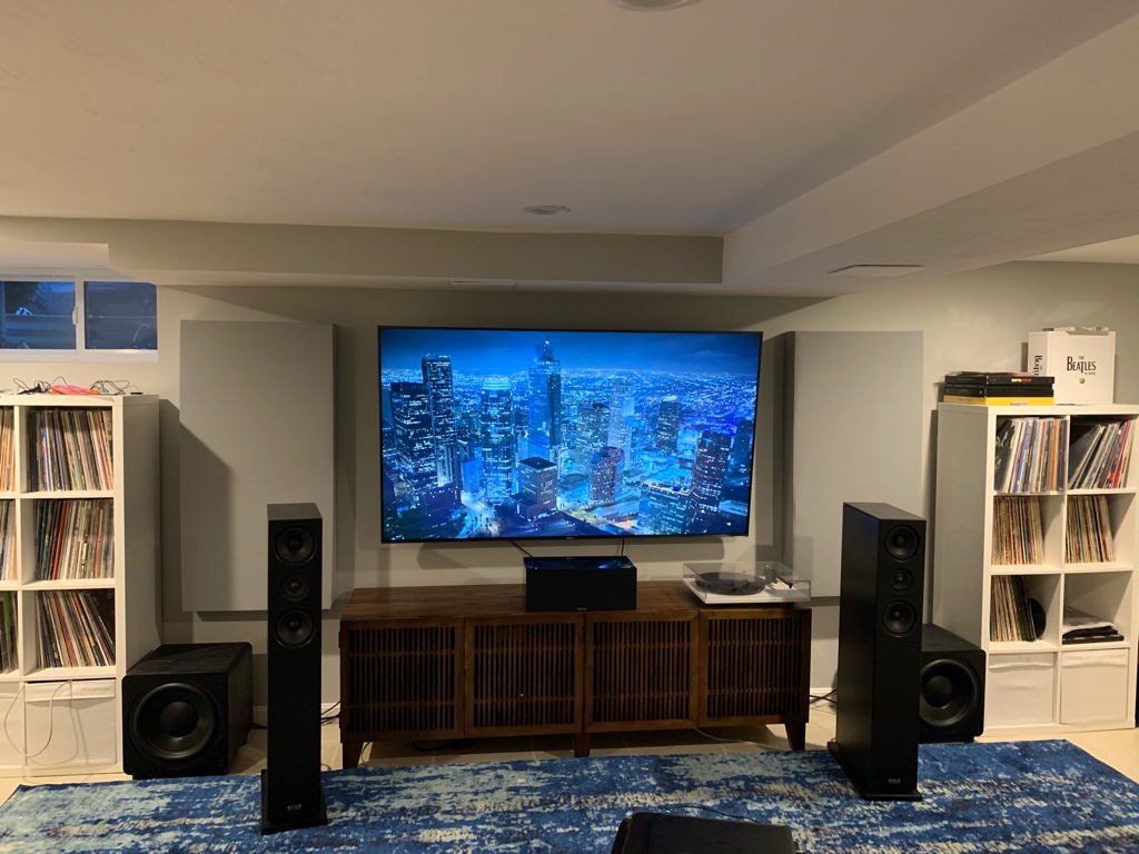

So I've done some reading around if I need an exterenal amp with my AVR including this https://www.audioholics.com/home-theater-connection/connecting-an-external-amp-to-a-receiver
My system started out as a 2 channel music system. I was using Audio Physic Classic 30's as my mains powered by a Rega Elicit R amp. I've just started turning that into a home theater now so I picked up the matching Audio Physic Classic Center which is a 4ohm speaker. My AVR is a Marantz 6013 and my mains are still being powered by the rega by leveraging the pre-amp out on the Marantz. My question is should I be powering the Center with more than just the AVR given this and the fact that it's a 4ohm speaker.
My surrounds right now are KEF Q150s an I'll be looking to add a pair of KEF in wall rear surround and eventually 4 in ceiling speakers.

My main speakers are about 7 feet from me, I listen at moderate volume and I have two SVS SB 3000's handling LFE. The debate is really that my center is 4ohm

This was exactly my question. I've been running it and it seems fine, just wonder if I'd be getting more out of the center with more/better power. I've not noticed any notable heat from the AVR and because I'm not running the mains from it I have a hunch that's a big piece of it. The mains are also 4ohm so that would be a bit much.

I’m just gonna leave things for now. Just watched Aquaman pretty loud and nothing skipped a beat.
