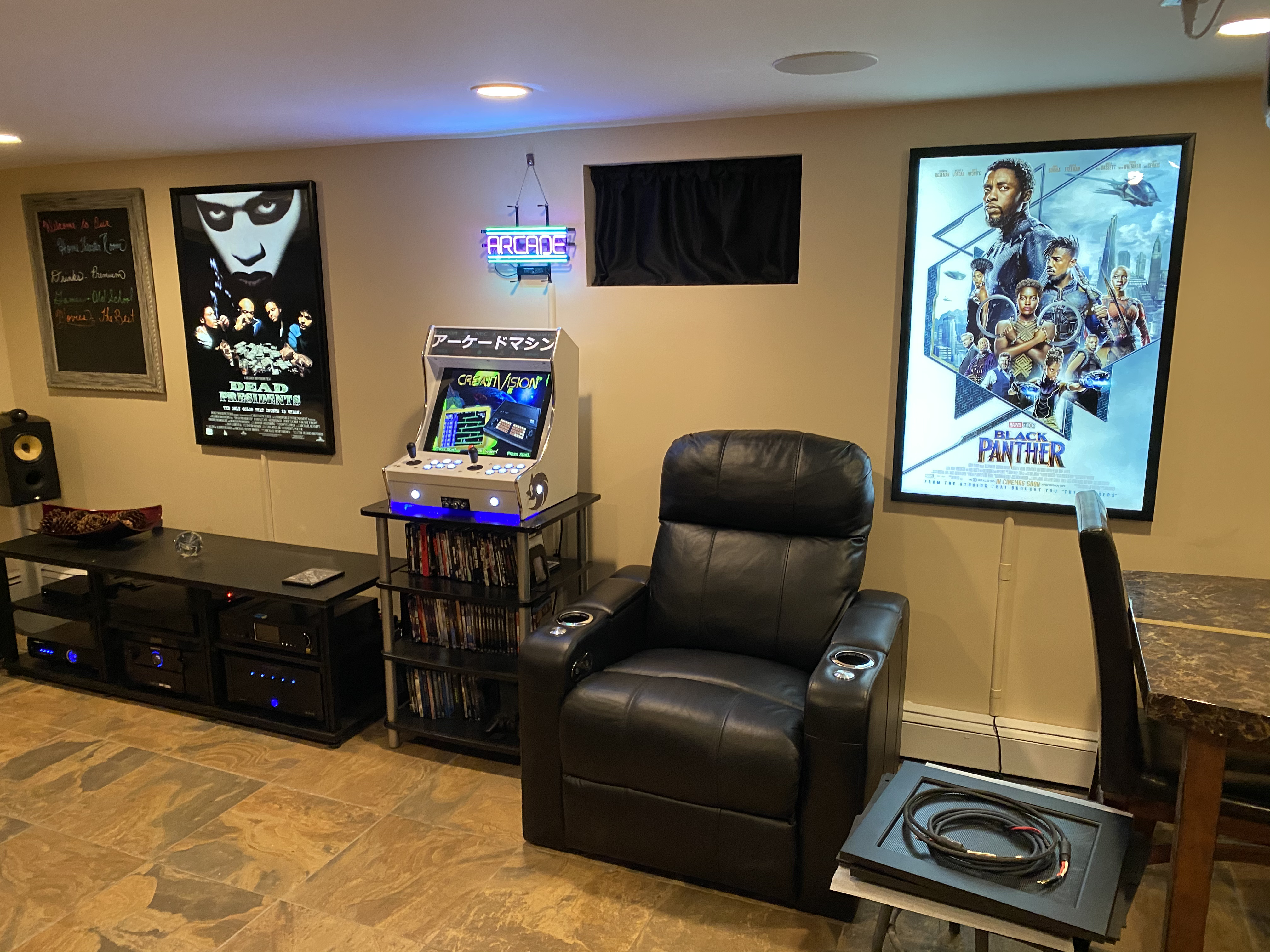

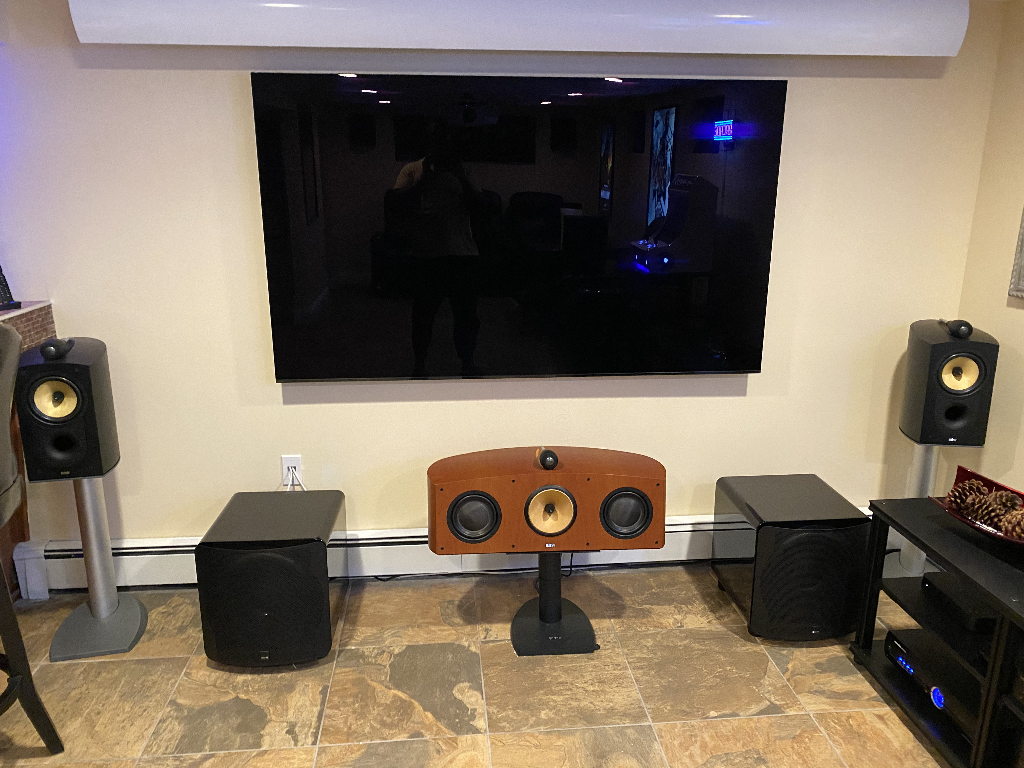

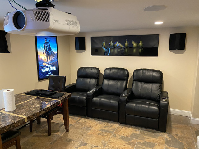

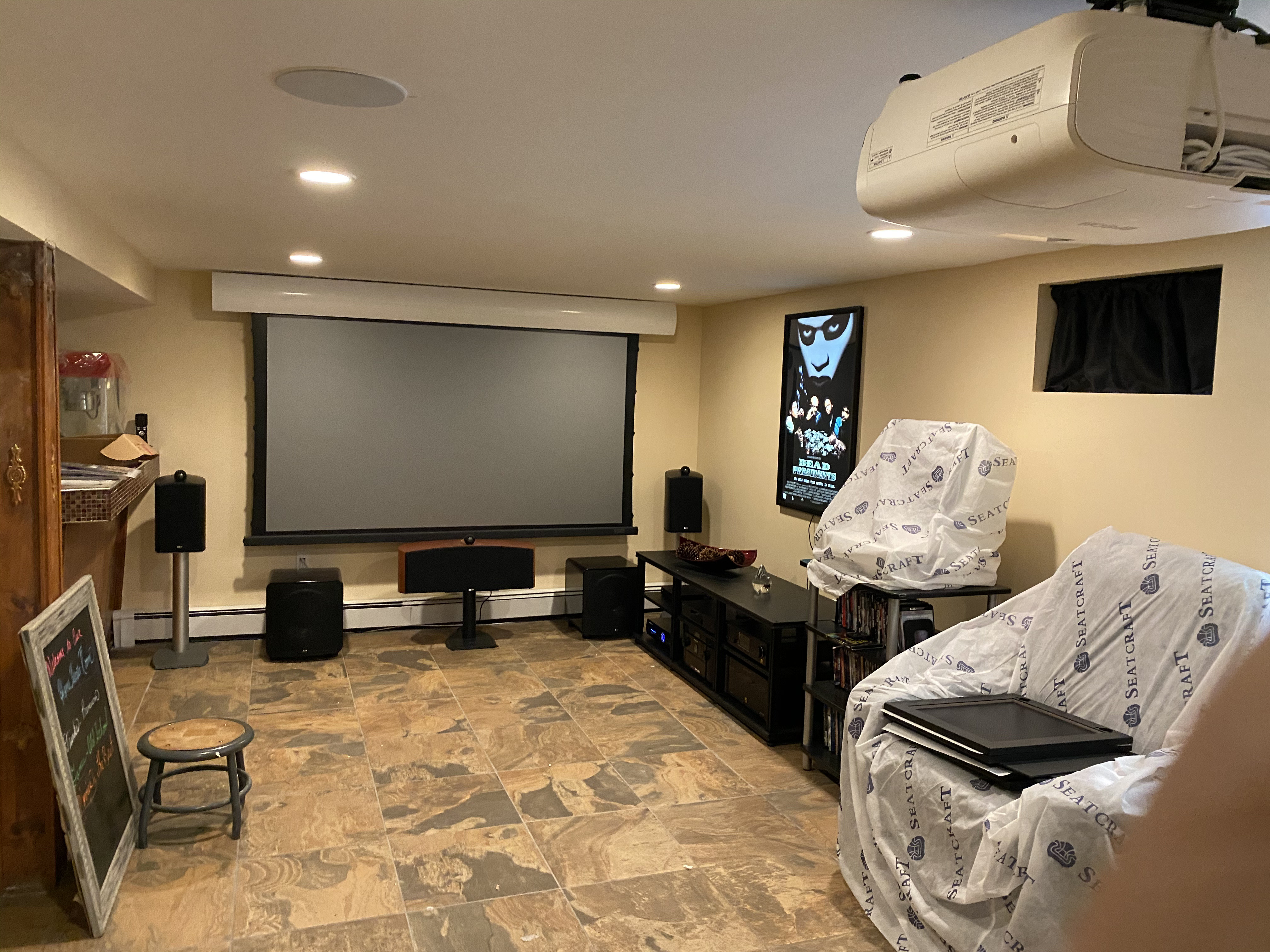

All true, The 5050UB definitely gives you a cinema like experience, especially in a room where you will have some low level of light. I wish I had a dedicated home theater room, my basement Is more of a family room but I made It work. You'll be happy with the 5050/6050UB

Nice setup man. I thought about doing a drop down screen and keeping my tv behind it like you have but I don’t think I’ll be able to do it.
