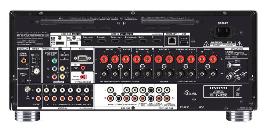

The MAIN feature of most 8K capable inputs is that they support 4K/120hz inputs, which is mostly useful for gaming. Kind of.
The main reason I want HDMI 2.1 on my new AVR and TV is for the 4k/120hz input. Not for just the refresh though, but for variable refresh rate. That's something I'd use quite often.
I don't really care about most of the other HDMI 2.1 features other than VRR. 8K is a waste of effort as we all know.
