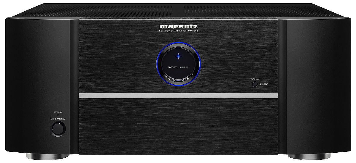

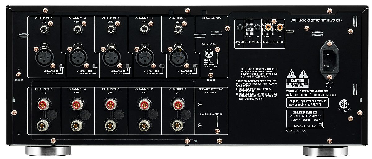

The pre is on the way. Really want a Bryston 9B, or ATI 4005. Gonna probably go with the Monolith 5x, or Emo XPA-5 though. Unless you got something for me??????
The Monolith or the Outlaw is the obvious choice as far as function/cost.
However, if you are interested in (and willing to pay a premium for) matching your Marantz pre-pro, you might want to get one of these:
https://www.amazon.com/gp/offer-listing/B003R7KMSI/ref=dp_olp_all_mbc?ie=UTF8&condition=all
It is rated as 140WPC, but I suspect that is the power output for only two channels driven, so the Outlaw 5000 which produces (as verified by the AH review/bench tests) over 120WPC for all 5 channels at the same time is likely a more powerful unit.
I believe in letting you know what options exist so you can choose. If you like the way it looks and have the coin, more power to you!:)
