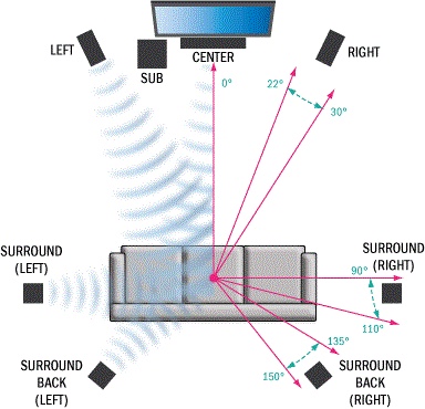

I'll use the diagram to address this so let me know if I'm not seeing this right. To add to shady's post. I would not do 7.1 with rear surrounds. They're meant to be behind, where unfortunately there is a window, and should imo, have 4-5' behind the LP to work right. 6 or 7 even. Maybe a pair above it? Also, the side surrounds should be directly to the sides, not in front of the listener. I think a better choice is as you mentioned to go with front heights. Many people have reported to enjoy this much better and I think your room is a prime candidate. I would sneak the couch just a little farther forward(within safety of course lol) and mount surrounds where you have indicated rear surrounds, pointed at the LP, and then go front height. This is what 7.1 with rears should look like.

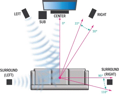

And 5.1
I'd go with 5.1. Plus front height.
