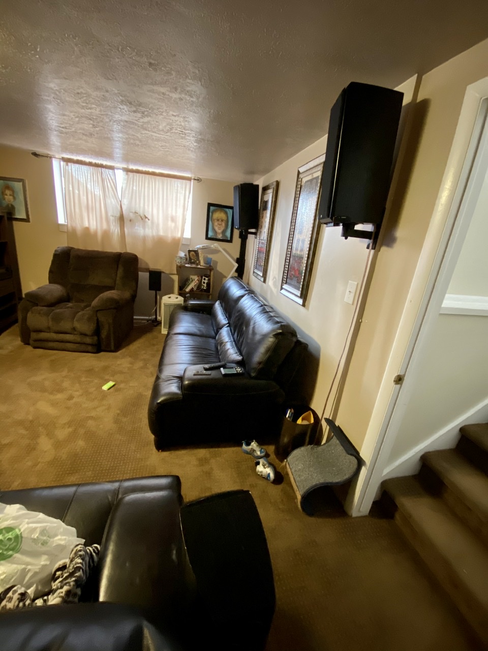

I’ve got a pair of T2/R for mains, then use three sv-661/r for rear channels and center. I added a pair of kind of a custom jobber from the RBH garage sale, it’s a small pair of reference bookshelves using reference 4” drivers on the sides. They are awesome little monsters. My main unit that powers it was the last great a/b flagship, a Pioneer VSX-59TXI. It’s 70lbs of MOSFET muscle. After using the room correction MCACC, it’s shocking how beautiful this sounds. I use a pair of RBH SA-400 amps to drive the reference subs. Words fail me. You can’t go wrong.

Wow, nice looking room and setup! As an observation you have the tweeters on the 661's to the outside: the speaker design guru at RBH, Shane, suggested that in my room they go to the inside. Could be my proximity to them but thought I would mention it to you. I hope to get my room up and going soon. Just finding the time and energy these days is tough.

That’s because RBH has them set up the wrong way on their web site photo. With tremendous effort, I swapped them to the correct configuration.
