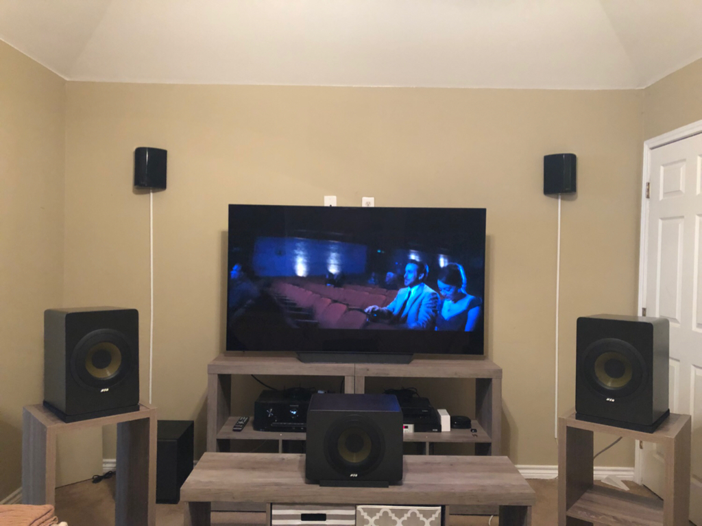

My receiver does Atmos but I can’t mount speakers in ceiling and have a square vaulted recess in ceiling so Upfiring doesn’t work well. I’m really just trying to figure out if I watch movies 90% of the time is front height better than rears and surrounds?

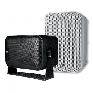

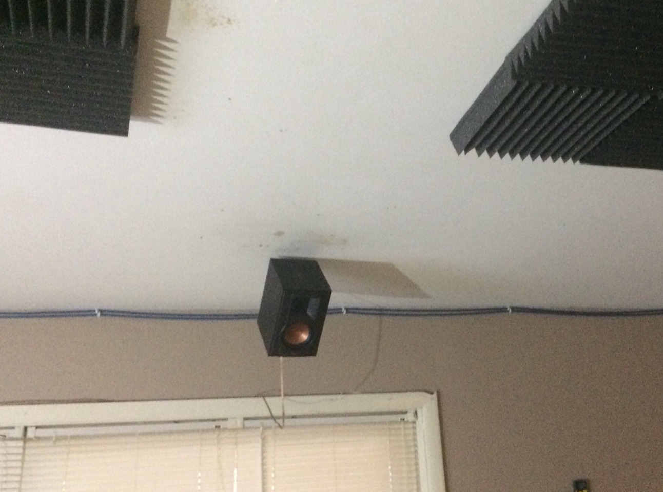

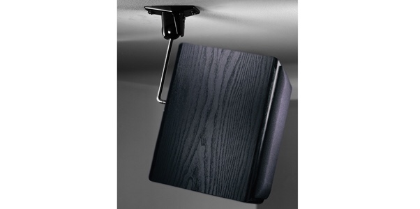

If that were my room, I think I would give up rear surrounds and try 5.x.4. But instead of going in ceiling which you said you can’t. I would try on ceiling. I see you’ve mounted to the front wall. With the right brackets you can do the same thing on the ceiling. Something like this would require a stud, or even a heavy duty toggle bolt but wouldn’t be impossible to hang.
These are good too
as they have a straight ceiling version and longer/shorter lengths.

Current layout.

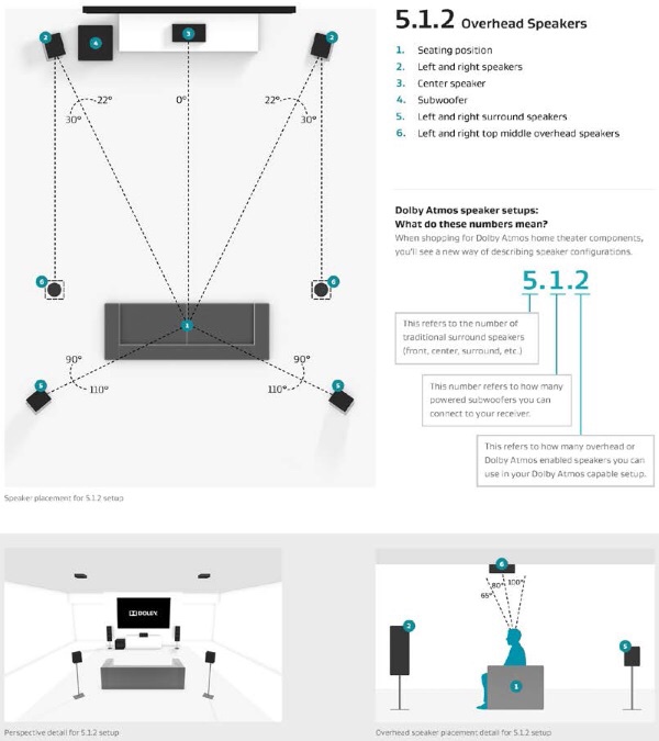

I have a Marantz 5011, 7 channels so 5.1.2 would be most I can do. If I mounted a set to the ceiling like you all suggest where would I place them?
I don’t mind selling the bipoles and buying a set like Polk OWM or some other angled speaker.
William Lemmerhirt
William Lemmerhirt
Ideally you’d be looking at this.

I think I can easily do that layout by mounting speakers at the highest point of the wall where it meets the ceiling. I really don’t want to make any holes in the ceiling.

SVS Prime Elevations can be mounted like this...

Mounting top middles to the side walls like you’re suggesting could work, but only if the distance to the side walls is not much further apart than the front speakers. For example, if the front speakers are 2’ from the left and right walls, it’d be okay, however, if the left and right walls are something like 6’ from the l/r, the imaging is going to be screwed up. Top middle speakers should be as close as possible to in line with the front speakers.
I think it might be important to address the speaker positions properly. “Top middles” would refer to some like x.x.6. Front height is what op is talkin about since he’s 5.1.2. Sorry, it’s just a peeve. Like when people refer to surrounds in a 5.1 system as rear surrounds.

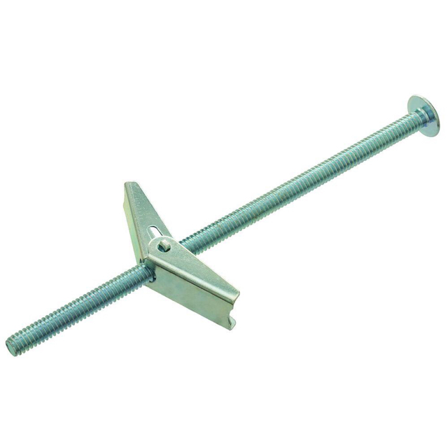

I have a smooth finish ceiling and eggshell painted walls so I feel like when I move out of this lease that covering holes with beige eggshell paint would be easier than matching a perfectly smooth white ceiling.
[/QUOTE] Mounting top middles to the side walls like you’re suggesting could work, but only if the distance to the side walls is not much further apart than the front speakers. For example, if the front speakers are 2’ from the left and right walls, it’d be okay, however, if the left and right walls are something like 6’ from the l/r, the imaging is going to be screwed up. Top middle speakers should be as close as possible to in line with the front speakers.[/QUOTE]
My L/R are 26 inches from each side wall.
