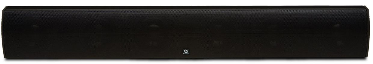

If you aren't opposed to used, I think this NXG LCR bar would be worth the risk. Its -3dB point is low enough that you could safely set your sub crossover at 80Hz, and I know the satellites from the same series are very impressive. Looks like a steal. If that doesn't interest you, then this Definitive Technology LCR would be my next choice.
Looking at the pictures of your room, the only other alternative I can think of would be to hang wall mount brackets near the ceiling and angle your fronts down, which probably wouldn't sound or look as good.

Since your room layout will prevent proper placement of speakers, and you are inclined to preserve feng shui, it is important to also pick the correct audio solution. Ceiling mounted speakers will be passable for surround duty, but absolute kill joy for front three. Rojo is on the right track with the LCR sound bar recommendation.

I thought about that Boston, but its f3 could be too high for a seamless blend with an 80Hz crossover point. Since the sub will be going behind the primary listening position, keeping the crossover point low will help keep him from looking over his shoulder for the bass. That's my theory, anyway. I've got dual subs behind me, and getting the blend right wasn't easy.
100 hz crossover should work fine for the Boston.
While Definitive may be a decent option, and they do make some nice stuff - their 60 hz
crossover is too optimistic and they have a long history for that. By some small miracle
the Defintive soundbar may hit 120 hz -3db
Not a lot of options for the OP - however, getting away from TV speakers is the key.:)
