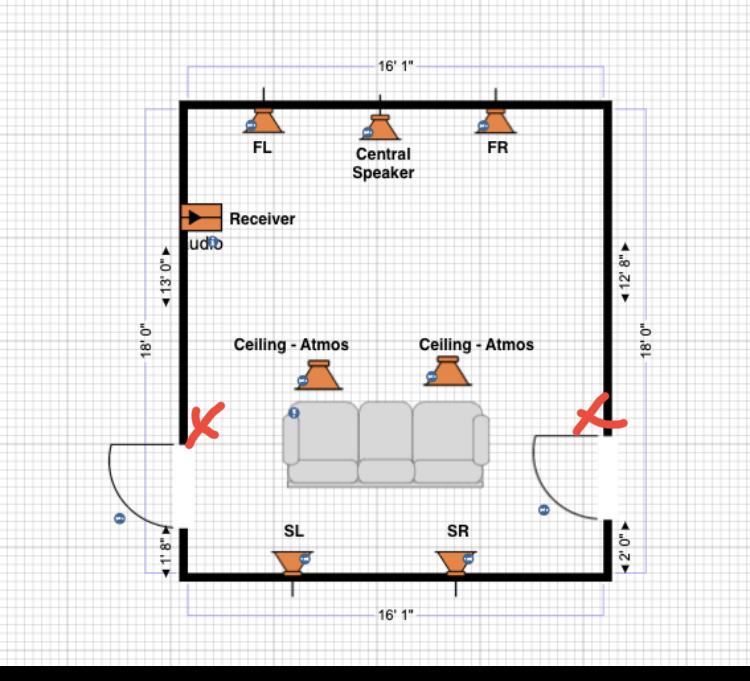

My budget is around $1K for speakers, receivers and subwoofer. Yes, we will have 2 in-ceiling speakers for Atmos and 3 in front (with one being central) and the other two for surround sound (SR, SL). Attached is the layout of room (16x18) and I have LG 4K projector (HU80KA) 150 inch.
Please recommend good brands for speakers, receiver and speaker cables.

I would also make sure the surrounds go to the sides vs the back wall.

Actually, the only reason I want to go with the Acoustically transparent screen is not having enough space below the screen (just getting 2 ft and not sure if I can place the center speaker Polk 265 horizontally as opposed to placing them vertically like other LR speakers).
Otherwise if Acoustically transparent screen can be avoided then we can also go with a paint, an alternative for screens is a high definition paint and can save around $500

The Polk 265-RT is designed to be mounted vertically, and if you put it horizontally it will have the usual issues with horizontal MTM designs. The Polk 255c-RT is designed to be mounted horizontally, but still will have some issues from the look of it.
I'd go with an acoustically transparent screen to avoid having a horizontal center speaker, and you could use three Polk 265-RT for the front speakers.
