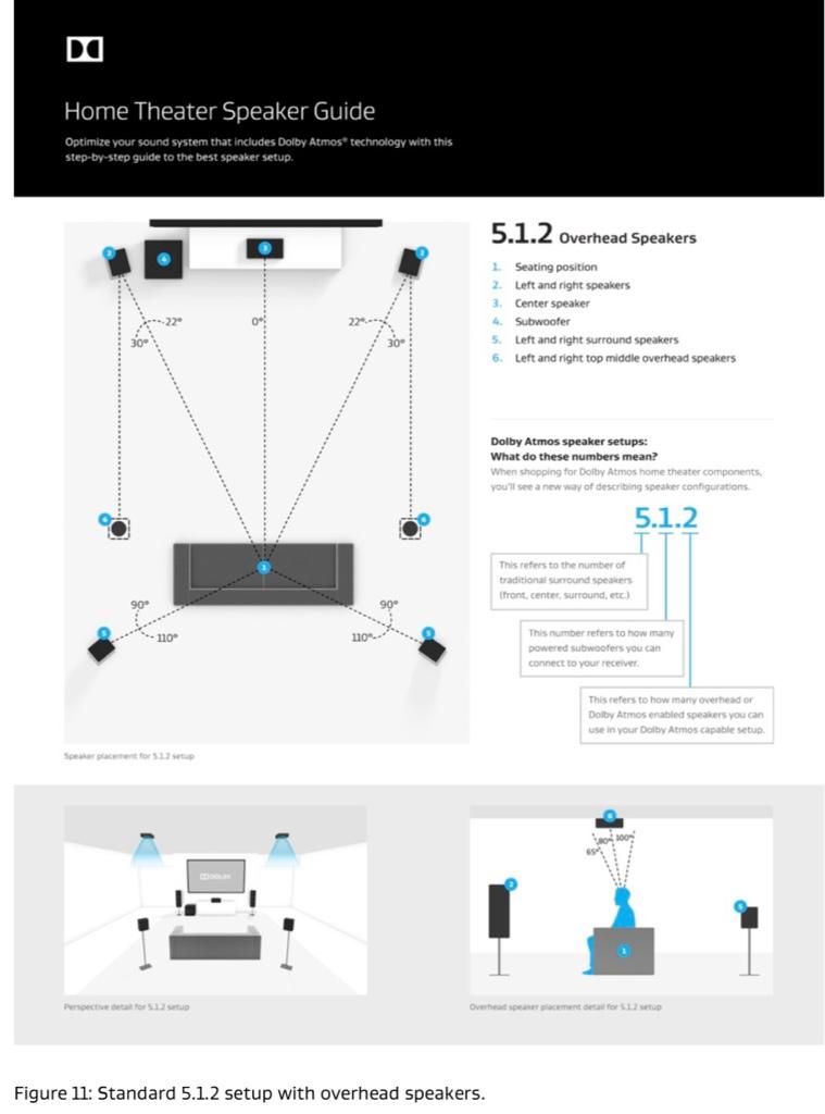

This image is a little generic, but if you you look at the side view, that’s what I would recommend. I don’t always agree that the best place for tops is in line with the mains. It depends on ceiling height and overall system layout. They even say so in some of their own more granular literature.
What is the ceiling height?
Well, that is the answer I was looking for.
To answer your question, the ceiling is vaulted in on both sides, so the speakers are kinda halfway between surround heights and top middles. I doubt it will make much difference, but I can try both settings on my AVR and see if I notice anything.
Thanks for your time answering. I remember seeing that in the Dolby Atmos Guide some time ago, I didn’t think to check there for their 5.1.2 recommendations.
Appreciated.

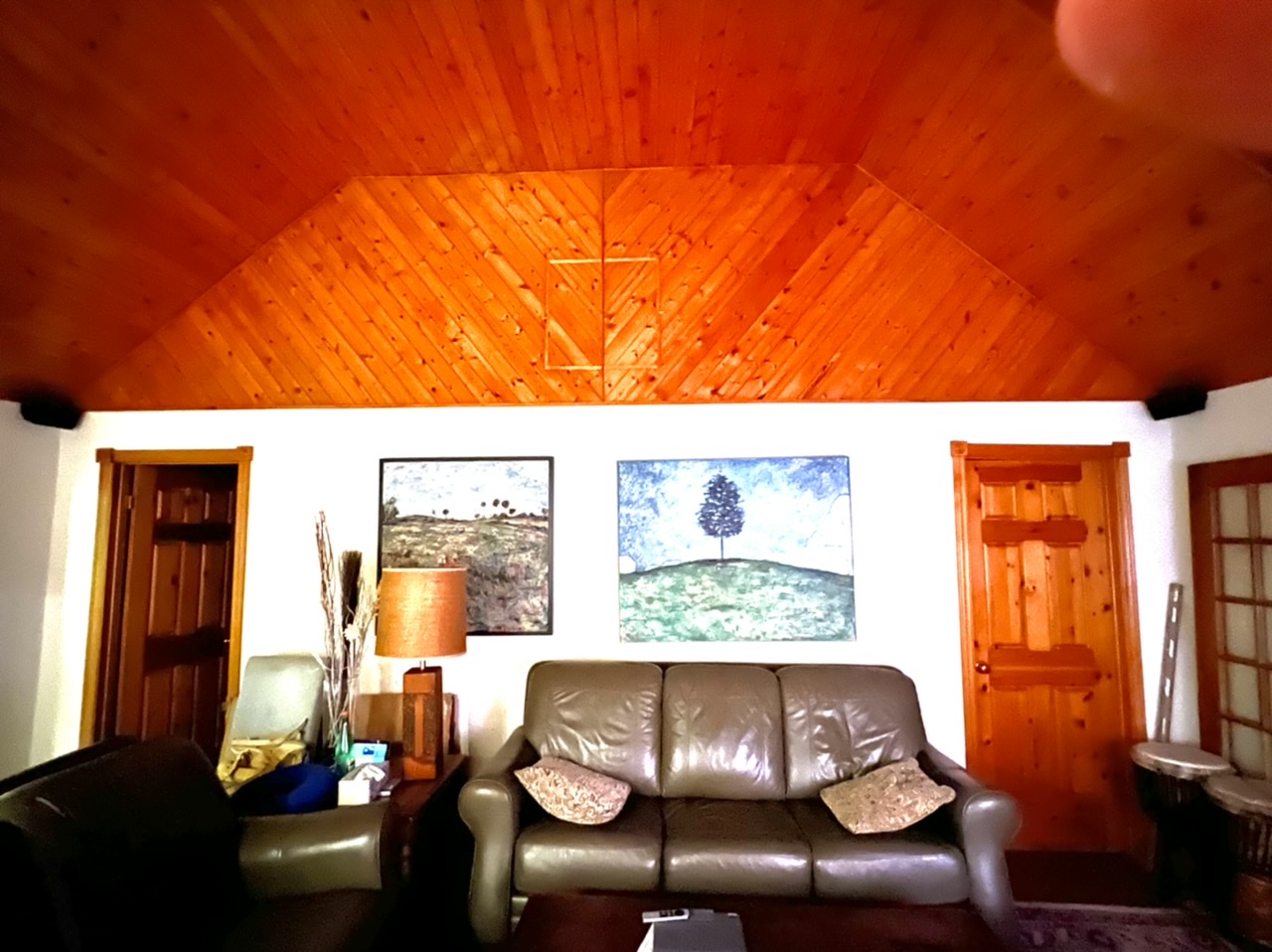

you can see the current surrounds, up in the corners. I plan to move those up, I can aim them. I will be getting some other speakers as surrounds and place them at ear height below current surrounds.
Seems totally reasonable to me. Moving them up and forward should work good. Curious, how high up were you thinking? It’s hard to just get scale from pictures sometimes, but this is helpful. I think I might go all the way up to where the angled sides meet the flat top.
It is about 13’ to the top. I am now thinking placement right in the corners where it starts to level off.
It is going to be a bit before I complete this, we are giving the room a makeover this winter. Will run wires then.
thanks again.

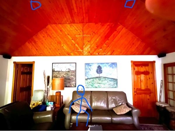

I’m thinking something like this?
13’ is pretty high but manageable.
Also, after the old man crack, I realized I’m only 3mo older than you lol.
Yes. Something like that. Out from the rear wall a couple feet or so.
…and I am an old man now too…
