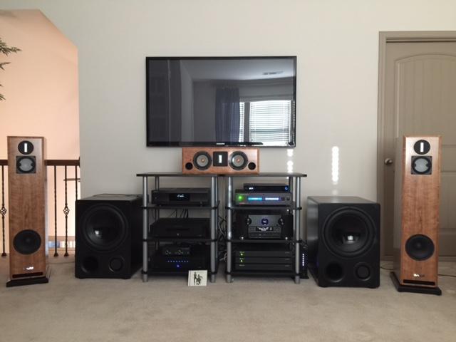

Yes...After about 6 mos of researching, I'd pretty much made up my mind to buy a pair of vtf 15h mk2 subs. The day I called to order I decided to let the sales guy do his job and see what he would suggest before pulling the trigger.
He said for your slightly under 2800 cu ft space, one ideally placed 15h mk2 would be more than enough, but ideal placement in most rooms is not a realistic spot...two 3 mk5 would be my suggestion for killer bass and he was 100% right. You'll probably work yours harder watching more movies, but these things are beasts!
Congrats!!! Have some help ready when they arrive. My HT space is an upstairs loft, I managed to get both up there with some smarts and sweat.
No...the Marantz pre/pro walks you through it and puts the sub through some test tones, etc. I had some flexibility on location so I moved them around, but ultimately flanking the TV was the best spot for music and movies.
Shown here flanking the TV...initially I had one along the TV wall and one near field behind the MLP and it was awesome for movies...localization really bothered me for music so this works best.
Subs are great in a 2.1 situation, but they really can take movies to another level...I can't wait to hear your thoughts.
Enjoy!
Nice setup!
