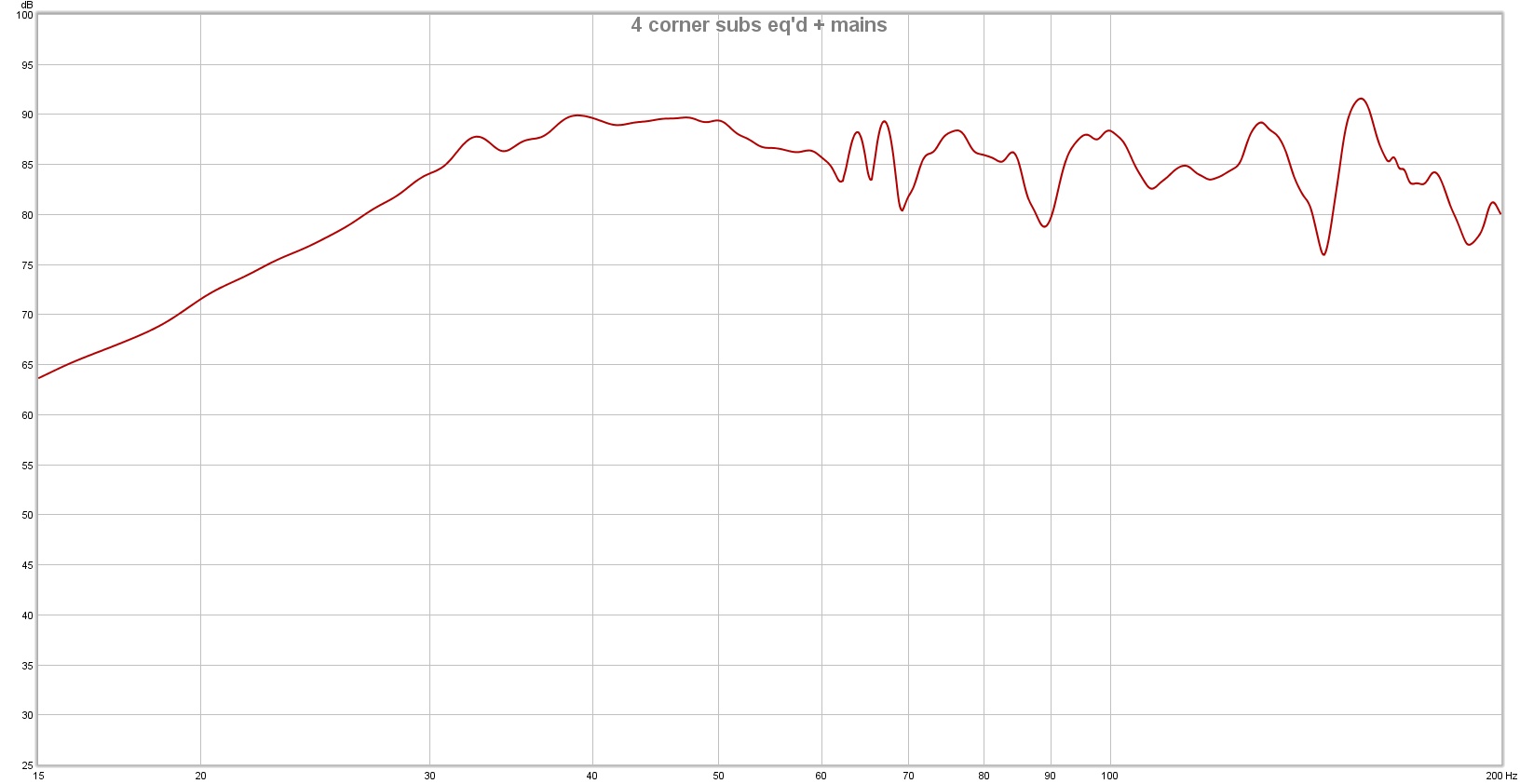

Maybe i haven't been specific enough and completely honest :s... to be honest my subs are 'rated' for 28hz, but no idea if that's their -10 or -3 specs om paper
I use REW and from 30hz downwards to 15hz i have a slow downward slope, but because of the multiple subs my -10db measurement is approx. 20hz, as in the multisubs help a lot there, where as one sub falls of much more quickly...
With the EQ from the 4way advanced plugin from minidsp i have been able to get the within +/-10db from 60hz to 120hz, but from the top of my head there are like at least 4 room modes, so lots of swings between 60hz and 120hz.... So i guess it's not terrible but i am interested if those ceiling subs would help reduce those modes, cause although EQ in the low frequencies does help a little with 'ringing' i have noticed that 'opposite' subs so to speak do much more for reducing modes and ringing than EQ does...
Hence my question about the extra ceiling subs :)

Eq helps yes, but i find that reducing modes with multiple subs helps better as of yet... in the end i still use eq not only to create a curve but also to 'fix' things and the less i need eq for the latter the happier i would be...
About the deviation you talk about, i might have used it incorrectly... as were my stated claims of my frequency response in the low end... so included is a pic of my freq. response... it looks more like a dev. of +/-5db then, although the max swing is 10db so i am somewhat confused about the terminoligy...
As you can see up to 60hz it's not bad, but from 60hz to about 120hz it's kind of a mess, even after 4 bands of eq for 'fixing' things and 2 bands to 'shape' a desired curve over the whole, then above 120hz i no longer have control of what happens cause i only have the means to do bass managment at the moment.
So i did EQ the subs as a whole, because even though individual eq'ing of subs could help, it's a PITA because of the many phase variances introduced by eq per sub as apposed to the whole.
But that extra minidsp i talked about would come in handy because of individual gain/delay(/phase) control... But i guess it wouldn't strictly be necessary... i mean, none of this is necessary... it's supposed to be fun right? :s
I'm worried that because of my room dimensions i am SOL, hence my question about ceiling subs... But you're probably right and the mighty intrawebs has turned up nothing about this... So maybe i just need to go and do it and report my findings and win a noble prize or something ;)
But my ridiculousness aside, and even though parts of your post i took slightly personal as a kick in the nuts (i'm just doin my best here you know), thank you for your reply and information.
That’s really quite good response, even above 60 Hz. IMO you’re fretting to much about what’s going on above 60 Hz. The ripples between 60-70 Hz are probably not audible anyway. If you’re using an 80-90 Hz crossover, any EQ you do in that range is going to be blown out by the main speakers once they’re added to the equation. :)

I've only played with it for a couple days and the measurment i posted earlier is the best i can do so far...
This was with EQ on all 4 subs as a whole, so no individual EQ, but with some individual delay. I don't smooth my measurments at all at lower frequencies to start with, so the picture i posted is without smoothing... by the way in my posts and the picture you can find some basic info on my config.
As far as i could figure out the 'troubles' i'm having are due to height modes but also tangential modes where height (and length) is concerned and to a lesser extent oblique modes...
