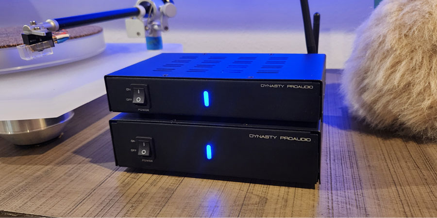

It’s not often an inexpensive wireless audio system comes my way that impresses me with the high level of performance it provides. For $300 you get the 200 watt (100x2, 4 ohms) Dynasty ProAudio's WSA-5RP Wireless Amplifier which is a seriously affordable solution to power a pair of surround speakers wirelessly, or to bring to life a pair of passive speakers you may have lying around.
