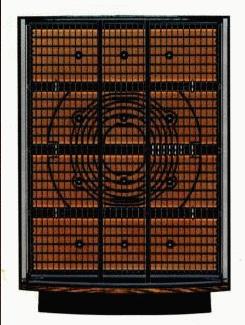

One other point, since you live in the UK.
If you are smitten with electrostatic speakers, you really should look at the Quad electrostatic speakers. These are without question the finest electrostatic speakers in the world, and have been over 60 years. Peter Walker solved the beaming problem a long time ago. You so not need and should not use a center speakers with these speakers. They absolutely do not need one. If you drive them with the Quad current dumping amp, then you have one of the best systems money can by.

Interesting. I've dreamed about owning full-range Quads for a long time, but thought they were not capable in a surround system at THX levels. Don't they have protection circuits notorious for cutting out?
This is the first I'm hearing of not needing a centre due to lack of beaming. Or of the current dumping amps. Do you have articles you can link that explain these ideas?
Yes,Peter solved the beaming problem with delay lines.
Yes, they do have protection against over driving. All electrostatics will not survive even one over drive. The makes a spark and a home in the membrane and an expensive repair.
They play plenty loud in most rooms to me, but will not reach insane levels.
As Quad recommend a center should not be used. This would be a massive down grade to the system. These speakers produce the most stable imaging of any speaker I know, and DO NOT and should NOT have a center speaker.
