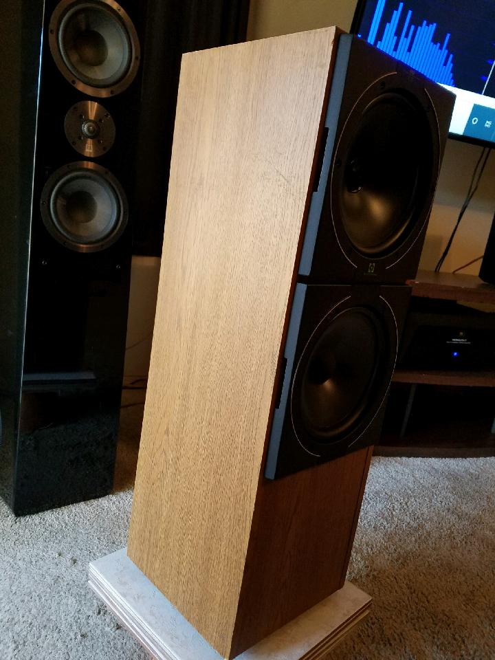

It's fun, but I'm backing up on speakers and my wife might kill me if I buy any more. I got away with ordering a pair of Sierra Ribbon towers a couple weeks ago (the direct result of a Craigslist find, will be here Tuesday!:D) but I think that's the last straw before the last straw if ya know what I'm sayin'. I've been intentionally avoiding Craigslist since, lol.
*Edit: In the second image of the KEFs you can see one of the Sierra 2 bookshelf speakers I also found on Craigslist in the background. That slot is for the RAAL ribbon tweeter. They're amazing speakers and what made me want the towers!
