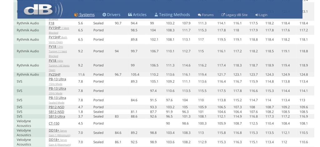

This chart isn’t quite fair because the SVS listed is the pb12nsd. It’s not as good as the pb2000 but they’re closer than the SVS ultra. Even adding 6db to the NSD’s numbers which is what you might expect by adding another, so two NSD’s. The fv15hp has higher numbers everywhere. Much more so as you get to mid bass range. So you’d have more output plus nice tight bass. I think you’d like it. This is where I pulled the image from.
