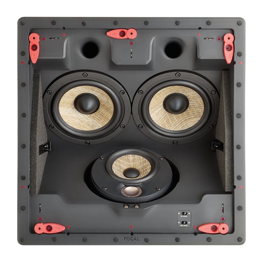

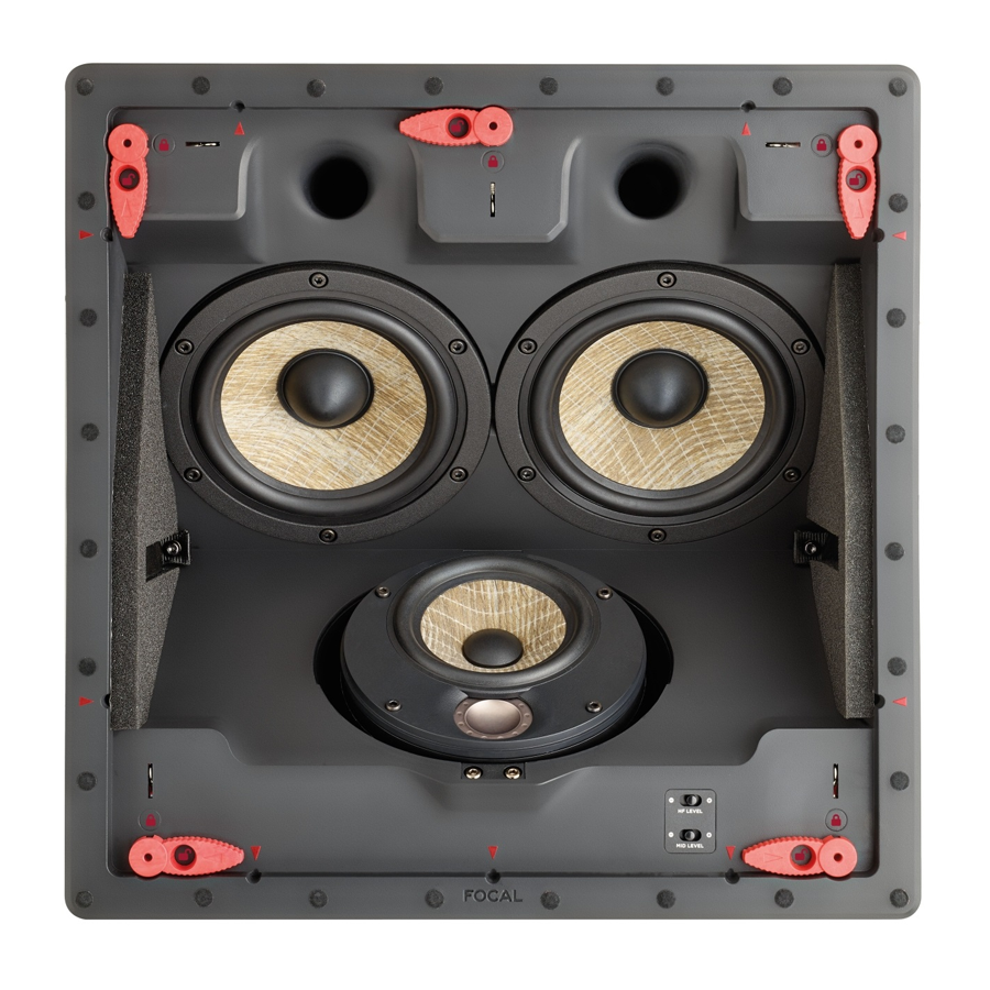

curious, what are you using for "Atmos" speakers?
The Focal 300 ICLCR 5's
Finally an atmos speakers that can keep up with the rest of the system. Perfect 35-45 degree angle built in. Fully movable mid and tweeter so I can direct the sound perfectly to where it needs to go
I'd show you a picture of them in my room but this phone doesn't allow me to downsize my picture files.
I'm going to post a review of the new Focals this weekend and will use a different phone to upload the pictures of them installed in room
